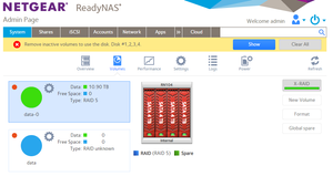

Remove inactive volumes to use the disk. Disk #1,2,3,4.
Wondering if someone can help... I can't access any of the 4 hard drives in my ReadyNAS 104. As a result all network shares are inaccessible. I'm running firmware v6.10.4 and the admin web inte...

What NAS do you have? If it's an ARM model, md0 is not BTRFS. But that's not the problem, anyway. md0 is the OS partition. Your /data partition is most likely md127, which isn't mounted properly and is, thus, your problem.

One other thing you can try is to boot up with just three drives, trying each combination. It is possible that one drive is causing the problem and the volume will mount degraded (without redundancy) without that problem drive.

I have a ReadyNAS 104 with ARM processor. As mentioned above I don't see `md127` in `/dev`. Could this be the reason for the issues and do you have any tips on trying to remount this partition?
Sandshark wrote:One other thing you can try is to boot up with just three drives, trying each combination. It is possible that one drive is causing the problem and the volume will mount degraded (without redundancy) without that problem drive.
I've attempted this several times and had no luck: - I'm always faced with the same message telling me to remove all disks :smileysad:
