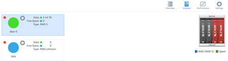

 Hi everyone,  one of my 4 2TB drives (#2) failed in my RN104. I went ahead and bought a replacement, but after insertion it looks like i get the "remove inactive volumes disk 3,4"; with some of my dr...

 Sep 22 13:17:49 NAS mdadm[2171]: Fail event detected on md device /dev/md0, component device /dev/sdc1 [Fri Sep 22 13:50:34 2023] sd 3:0:0:0: [sdd] tag#13 Add. Sense: Unrecovered read error - auto reallocate failed So both sdc and sdd are detected as failed. Unfortunately not a good sign. It'd have been better if one of the disks was just out of sync. I'm not sure if either of these is disk 1, you might want to double-check that by looking at disk-info.log.
 schtroumpfmoi wrote:
 I guess my main question now is: is there still a way i can force a rebuild / should i try to remove/readd the faulty disk ? With single redundancy, you need three working disks to rebuild the fourth. You don't have that. If the disks can be read at all, you could try cloning one or both. That might help with recovery. RAID recovery software like ReclaiMe might be able to recover some data from the two remaining disks - not sure. You can download it and see before you pay for it. You would need a way to connect the disks to a PC (directly with SATA, or using a USB adapter/dock).

Hi again,
Here is the extract of mdadm errors from system.log:
Sep 22 13:17:50 NAS disk_event_handler[19813]: mdadm: set 8:34 faulty in /dev/md1
Sep 22 13:17:50 NAS mdadm[2171]: Fail event detected on md device /dev/md1, component device /dev/sdc2
Sep 22 13:18:00 NAS mdadm[2171]: NewArray event detected on md device /dev/md1
Sep 22 13:18:06 NAS mdadm[2171]: RebuildStarted event detected on md device /dev/md1, component device resync
Sep 22 13:18:58 NAS mdadm[2171]: RebuildFinished event detected on md device /dev/md1, component device resync
Sep 22 13:29:16 NAS disk_event_handler[31784]: mdadm: hot removed 8:33 from /dev/md0
Sep 22 13:29:16 NAS disk_event_handler[31784]: mdadm: hot removed 8:35 from /dev/md127
Sep 22 13:37:50 NAS mdadm[2119]: NewArray event detected on md device /dev/md0
Sep 22 13:37:51 NAS mdadm[2119]: DegradedArray event detected on md device /dev/md0
Sep 22 13:37:51 NAS mdadm[2119]: NewArray event detected on md device /dev/md1
Below are some items i thought would be relevant from the other logs, the main one being
[Fri Sep 22 13:36:22 2023] md/raid:md127: not enough operational devices (2/4 failed)
Or is it just trying to reclaim data off the two valid disks and pray something is still readable ?
Many thanks for any insights...
