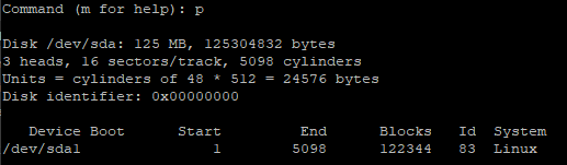

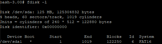

    Another problem was, that internal NAND also needs a proper partitioning scheme. Mine was screwed up earlier by deleting the partition and creating a new Linux partition using fdisk, so I needed to recreate it. Actually, the values for heads, cylinders and sectors were wrong.
    I had:
    And the proper configuration looks like this:

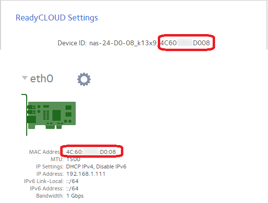

    For the record, I haven't found anything in the NAND content that would suggest that the serial number is stored there.
    For instance, the Device ID for the ReadyCLOUD is MAC based:
