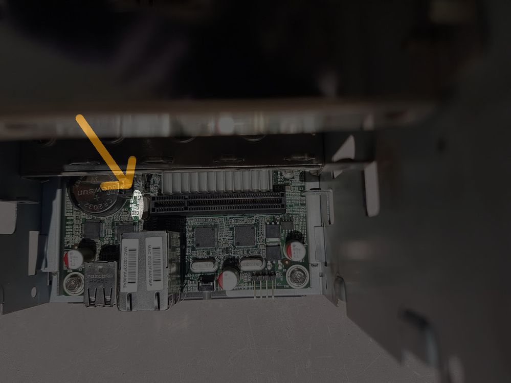

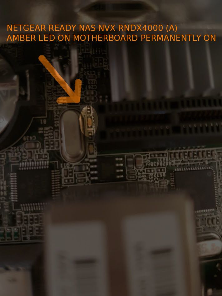

Only leds I see light on are:
1) the ethernet green led in the back
1) an amber led on the motherboard, permenently on.

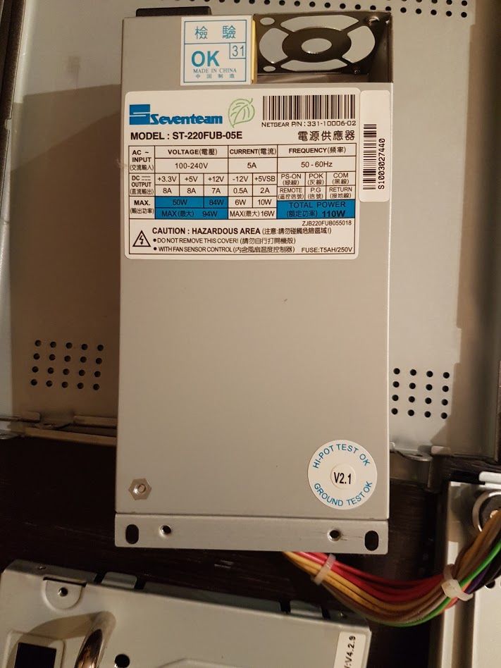

I suspect a PSU failure.

The amber light posizione on the NAS motherboradThe amber light permanently lights onPower supply disassembled from the NAS

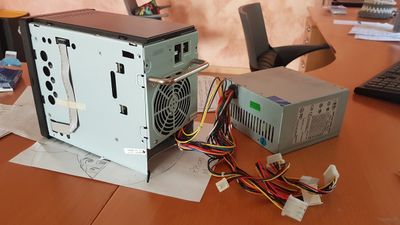

    I have connected the NAS to a PSU from an old PC I had at home.
    The NAS is now 100% working, so the NAS didn't power-on because the original PSU "Seventeam ST-220FUB-5E" was fault.
    Here it's how I solved, hoping it could help anyone has an out-of-warranty Netgear NAS that do not power-on anymore and wants to check if the troubles are caused by a defective PSU using a zero-cost old ATX PSU.
    As the RNDX4000 uses a modified ATX power connector, before to connect the PSU ATX 20-pin cable to the NAS, I have modified the PSU pinout as showed in document ReadyNAS_PSU_pinout.pdf, by removing the two –12V(Blue) and –5V(White) cables and replacing these with two +5V cables I found in a 12V 4-pin power connector that is also available on the PC ATX.
    A lot of video tutiorial show how to remove the molex connector from the 20-pin ATX port.
    Unfortunately the replacing PSU do not fit the NAS case, but for me this a little problem.
