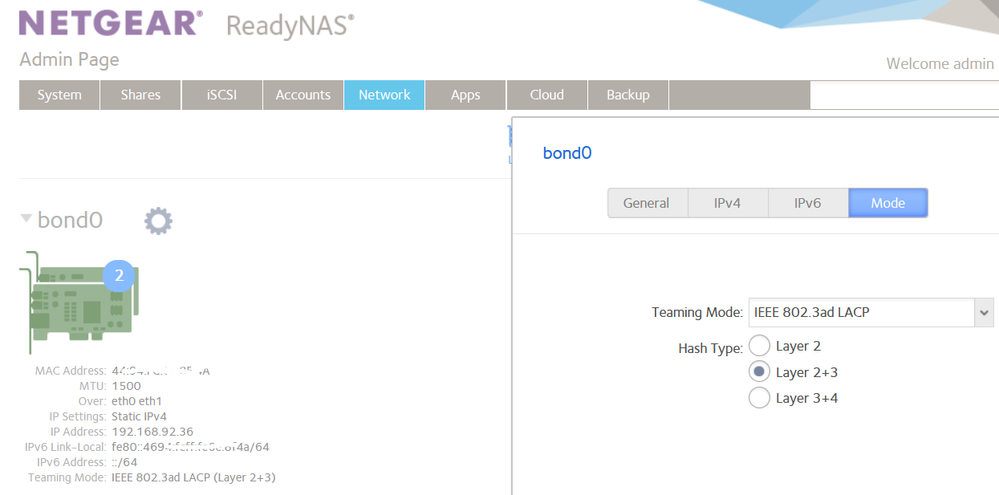

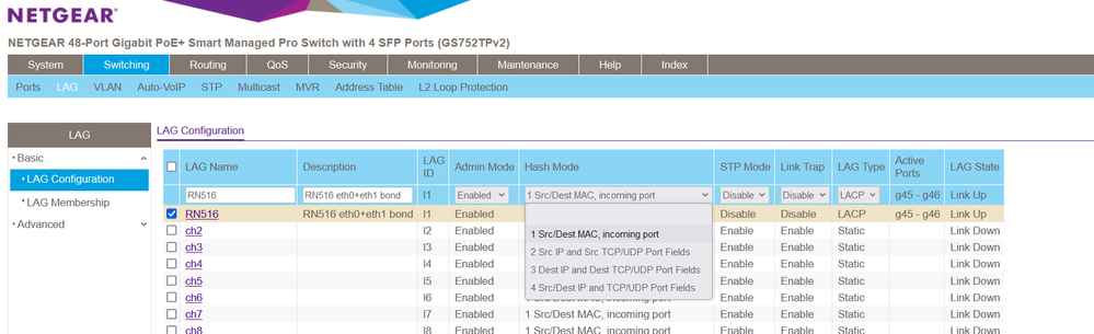

- dennis48755Jan 22, 2023Aspirant
The Hash Mode is configurable on my GS752 v2...
Below are my RN516 settings...
What are your thoughts?
Dennis
