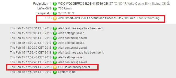

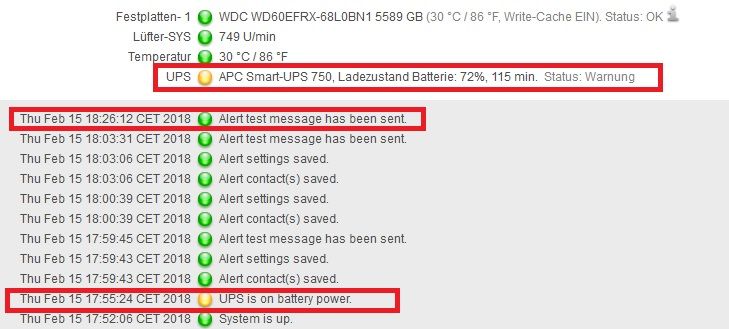

      I did the test before und now again with pictures
      As you can see the UPS and the NAS are running for 30 minutes without any reaction in a power breakdown situation because the batteries of the UPS are nearly full. For the note I sent alert messages 17.55 and 18.25 which can be seen on the pictures. Then I interrupted the test because I do not want to empty my UPS.
      Because of no load at the UPS this test can take a long time until the remaining runtime is low enough or the battery capacity falls under a certain treshold or ... so that the NAS get a signal from the AP9630 in the UPS to shut down.
      That is why I ask the above questions: on what information or signal and when will the NAS shutdown?
