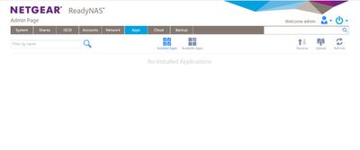

Anyway, I'd like to try something else, i.e. install Plex 1.41x on my RN102, running FW 6.10.10, from scratch. You see, I've deleted Plex 1.11 from my device because it was causing problems without any obvious way of applying a solution, so I switched off Plex and deleted it.
However, I do not see anyway of installing Plex 1.41x manually on my RN102, whereas I could quite easily click a virtual button on my RNDuoV2.0, search my PC's HD and install or upgrade my Plex app from there. But there seem to be no such facility on the RN102 or RN104, what am I missing?
Here is the Apps section of my Admin page, as you can see there is nothing there that indicates a facility to either manually install or update an application.
Also, the Upload and Available Apps buttons both give me the following error.
So you see I am stuck, I cannot see any facility where I can do anything to affect a pre-installed application or install a new one.

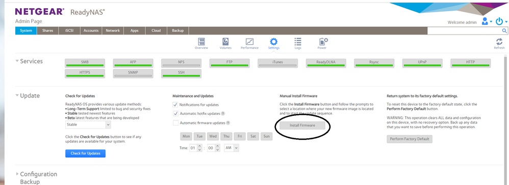

- StephenBSep 23, 2024Guru - Experienced User
You can do it from here:
Just ignore the fact that it really isn't a firmware update.
This is also where you can downgrade back to 6.10.9. Just get it from here
and extract the firmware binary from the zip file.
- ukbobboy01Sep 24, 2024Apprentice
Hi StephenB
Thank you for that solution, I would never have guest that the Install Firmware button also doubled as an Application Update button as well.
You know, this sort of dual usage facility is not intuitive, obvious or has any clues that would lead a person to believe that such a dual facility function exist. For example, why would a function dedicated to updating/maintaining the NAS's operating system also install and update a software application made by a different company, i.e. Plex.
I just don't understand it, anyway, once again thanks for this solution because I would not have worked it out for myself, it doesn't seem logical.
