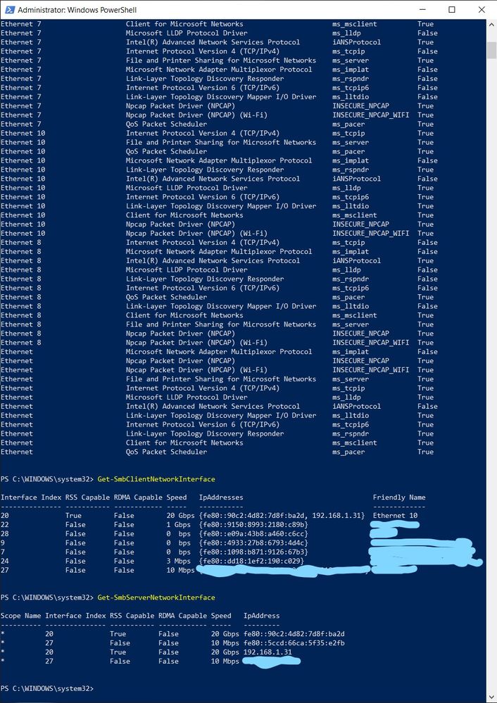

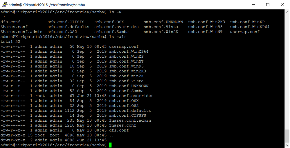

Hi Guys, after some hiatus am back examining SMB multichannel. Picture attached is SSH view of RN212. In the etc/Frontview/Samba directory, I do not see any subdirectory named "addons" per the link provided earlier. The only "addons" directory I see is under etc/Frontview/Addons and that directory has but one file, addons.conf which has a "bin" designation after it so it appears to be a non-editable binary file. When I type "cat addons.conf" it returns nothing. I'm a newbie with SSH syntax, I used "ls -alr" to list out all hidden directories, etc., just to make sure I didn't miss something.
Basically, I'm stuck at this point. Not sure where the appropriate file is located to add smb multichannel commands.

If no apps have created /etc/frontview/samba/addons and it's addons.conf file, you have to create them yourself. If you look at /etc/samba/smb.conf, you'll see it is referenced in an include statement.
- jimk1963Jun 21, 2020Virtuoso
Thanks Sandshark ! I see the include statment "include = /etc/frontview/sama/addons/addons.conf" and understand I must now do the following:
1) Create subdirectory "/etc/frontview/samba/addons"
2) Create a text file in the above subdirectory called "addons.conf" with the desired SMB multichannel commands

- SandsharkJun 21, 2020Sensei
You need an applicability header for it in the file, too. Most likely [global].
Thanks Sandshark . I've created the directory using "mkdir addons", and have created the file using "touch addons.conf". So now I see the file. But how to edit addons.conf?? I've tried:

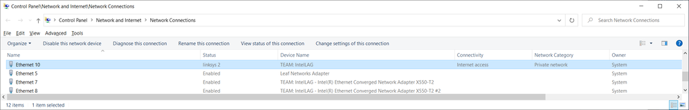

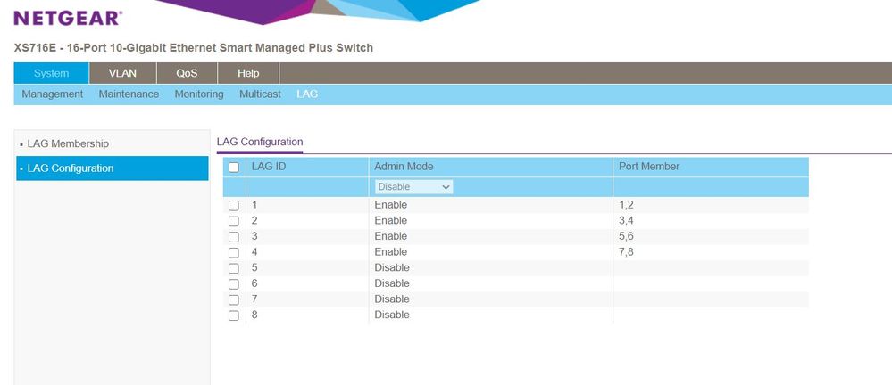

After all that, am seeing no better performance than before, on either the 10GbE RN528x or the 1GbE RN212. Config:

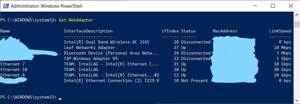

1) Intel X550-T2 NIC is in Static Lag mode, Windows shows the team as a 20 Gbps link
2) XS716E switch configured with static LAGs
Ports 1/2 = PC (X550-T2)
Ports 3/4 = RN212 (2 x 1 GbE)
Ports 5/6 = RN314 (2 x 1 GbE)
Ports 7/8 = RN528 (2 x 10 GbE)

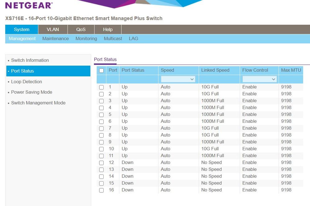

Also StephenB regarding your MTU question, the XS716E doesn't have a configurable MTU from what I can see in the management console, for either the port or the LAG. It's auto-populated at MTU=9198 and not editable.
Pinging any of the 3 NAS boxes from the PC, max payload without fragmenting is 8972 bytes so +28 gives MTU=9000 optimally if I understand correctly. The PC NIC's are set for jumbo frames (9014 bytes, not tune-able) and the NAS's are each set to MTU=9014. I can drop the NAS MTU's down to 9000 without affecting max payload but any lower and I start to see fragmenting. Curiously, setting NAS to MTU=8992 still results in max unfragmented payload (MUP) = 8972 bytes, but MTU=8991 or any lower number results in a byte-for-byte reduction in max payload. For example, NAS MTU = 8980 results in MUP = 8960. I thought the byte overhead was 28 bytes but I guess that's 20 bytes for TCP and 8 bytes for UDP... so I guess the generic ping command doesn't include the UDP header? Not sure about that. Anyway seems I'm getting max jumbo frames from the pings (8972 byte MUP).

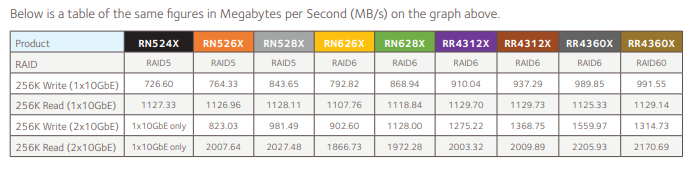

Please reference: https://www.downloads.netgear.com/files/GDC/READYNAS-100/ReadyNAS_OS_Performance_Guide.pdf
In this report, they use pedestrian Seagate HDD's. Their setup is different than mine - I'm using just one PC for testing, while in the report they use 4 PC's to push/pull data from the 2 10GbE ports via switches that sit in-between. As you can see, with the RN528X they can achieve 981 MB/s (just under 8 Gbps) writes and 2027 MB/s (16.2 Gbps) reads. Using HDD's. My box came with Toshiba MGO3ACA400 HDD's which are similarly spec'd.

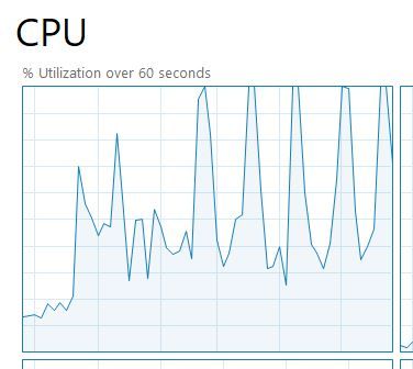

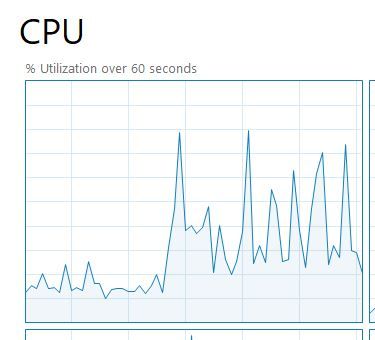

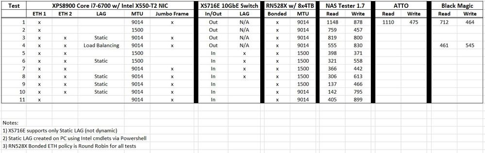

Thanks StephenB and schumaku for your inputs, I've run some tests that you may find of interest.
General comments:
1) I wasn't reporting earlier that the system suffered from fragmentation. Rather, I just ran tests at different MTU's to force fragmentation so I could confirm those boundaries. With MTU=9014 on both Intel X550 NIC and on the NAS, I don't see any fragmentation
2) I'm not convinced at all that Jumbo Frames are immaterial to performance in modern systems. My test data shows quite the opposite, maybe you can enlighten me as to why
3) By far - the best performance I can achieve is 1 ETH connection directly to the NAS, where the NAS is in Bonded Mode (I ran all tests with NAS in bonded mode so cannot comment on single NAS ETH connection). In this mode, I achieved writes in the mid-800 MB/s range and reads in the 1100-1200 MB/s range using NAS Tester 1.7. Using actual file transfers I saw writes in the 700 MB/s range and reads in the 900-1000 MB/s range. Far better than anything I achieved with a switch in series or with Static LAG.
4) With the switch included, one PC ETH and NAS Bonding with all Jumbo Frames (last run in table), I'm at 400MB/s reads and 900 MB/s writes, back to where I started.
What I don't understand is, compariing Run 1 to Run 12, why adding the switch in series is causing so much degradation in Reads. The switch doesn't offer much configuration, mainly static LAG (which is disabled for those runs).
I'm sure some of these runs are considered "invalid" by network experts, for example I'm not sure setting up the PC with static LAG with a direct-to-NAS connection makes any sense. From what I've read a switch or router should be in-between but anyway, the data is there for analysis.
Also, the few ATTO/Black Magic runs don't agree well with the NAS Tester 1.7 numbers. Guessing they do things quite differently and probably ATTO and BM are more realistic (I guess).

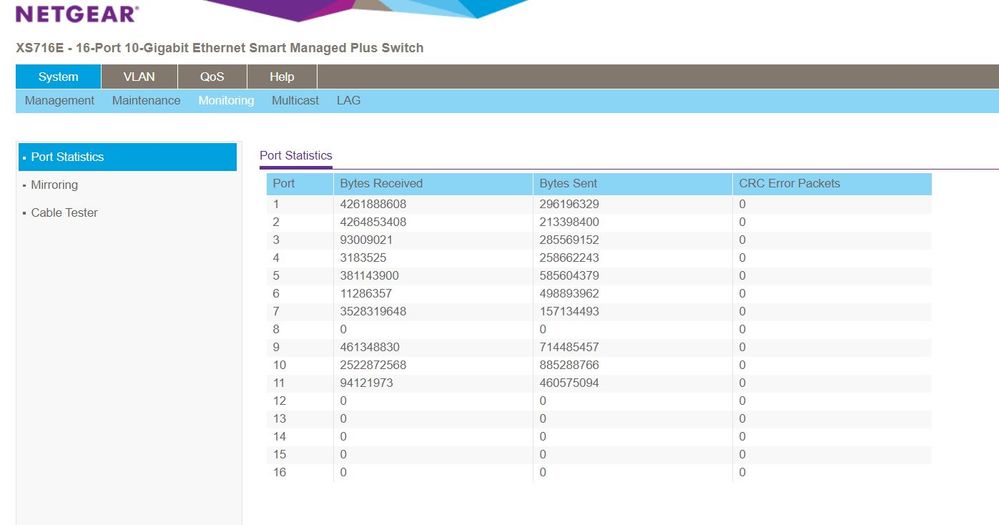

Maybe look at the packet statistics on the switch before and after the test (looking for errors).
Also, is flow control enabled on the switch ports?

2) XS716E switch reports CRC Packet Error Statistics as shown below. If this is what you're referring to, I'm not seeing any errors.

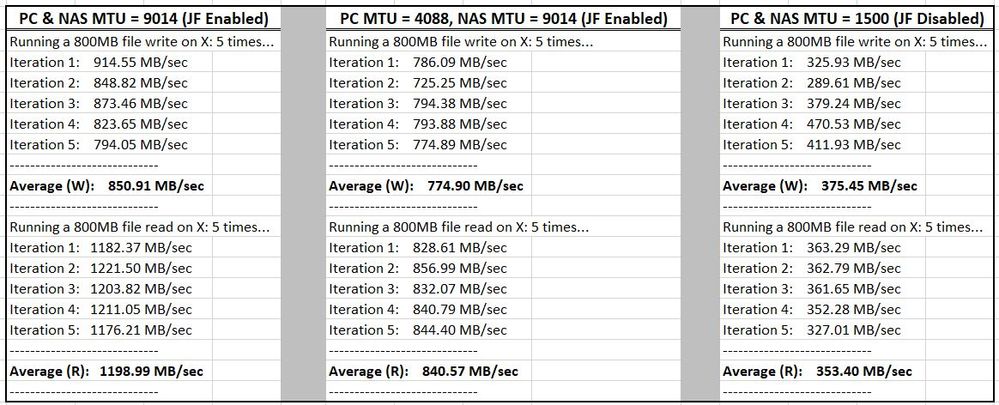

4) Experimented with different MTU sizes. JF on only one side (either PC or NAS) with 1500 on the other side gives poor results, as expected. Didn't include those numbers but they are basically the same as Column 3 below (PC/NAS both at MTU=1500). Setting the NAS to a fixed MTU=9014, and stepping up the PC MTU (first MTU=1500 in Column 3, then MTU=4088 in Column 2, then MTU=9014 in Column 1), the reads and writes continue to climb with highest JF packet size. This trend correlated perfectly with file transfers between PC-NAS using File Explorer. So I guess this confirms your hypothesis that the PC may be struggling with smaller packet size. Monitored CPU loading using Task Manager, and did observe that when PC MTU=1500 the CPU was peaking at 100% during NAS reads (even though the reported average never climbed above 37%). With MTU=9014 the peaks never get above 80%. Pic of each below.
Through all this, I've left those added SMB Multichannel commands in the NAS. Guessing they are harmless, and useless, at this point but just for completeness, all tests in these tables do have the commands in the \addons.conf file.
First pic: PC MTU=1500, NAS MTU=9014. Second pic: PC & NAS MTU = 9014

- MTU=9014
- Static Link Aggregation Enabled
XS716E Switch:
- Ports 1/2 (RN528X): no Static LAG
- Ports 3/4 (RN212): Static LAG Enabled
- Ports 5/6 (RN14): Static LAG Enabled
- Ports 7/8 (PC): Static LAG Enabled
RN212 and RN314:
- ETH Bonding Enabled
- MTU=9014
- SMB Multichannel "enabled" (if I did it right)
RN528X:
- No ETH Bonding
- One ETH port active, the other disabled
With this configuration, I can achieve read/write file transfer speeds around:
RN528X: 810/560 MB/s (1170/850 on NAS Tester 1.7)
RN212: 135/90 MB/s , 205/135 MB/s simultaneous multi-file transfers, (235/110 on NAS Tester 1.7)
RN314: 166/101 MB/s , same with simultaneous multi-file transfers, (236/108 on NAS Tester 1.7)
This configuration gives me the fastest 10GbE performance with the RN528X, while also enabling faster reads on both the RN212 and RN314. Interestingly, the RN314 with the 4 new WD Red 4TB drives can read up to around 170MB/s, not bad for slow-spinning HDD's. They are dead quiet so I'm happy. Reliability.. we'll see. Also interestingly, the RN212 with its original Toshiba 7200RPM HDD's (circa 2014) does great when copying multiple groups of files simultaneously (over 200 MB/s) but can't quite keep up with the RN314 with just a single block of files. Of course, the RN314 does have 4 disks compared to only 2 in the RN212...
Thanks StephenB , schumaku and Sandshark for all your insight and course corrections. System is tuned about as good as I'm going to get it.
