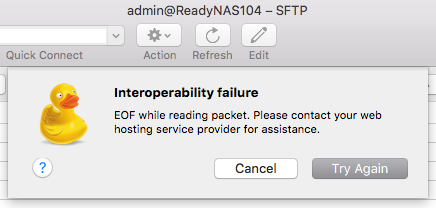

SSH connection closed (ReadyNAS 104, 6.5.0)
I am using a RN312 (main device) and a RN104 (backup device). Both have been updated from 6.4.2 to 6.5.0. Now I can no longer ssh or sftp into the RN104. sftp from MacBook using Cyberduck: ...
- Jun 07, 2016
Normally you'd be using ssh root@readynas104 not admin. Did you try root?
StephenB
Jun 07, 2016Guru - Experienced User
- _frantic_Jun 07, 2016Aspirant
Oops, you are right!
I was accidentally using admin instead of root, since I recently migrated from PC to Mac.
But admin has no shell on a RN104. (has this been changed for RN 312?)

- StephenBJun 07, 2016Guru - Experienced User
_frantic_ wrote:
I still have no luck with Replicate between my RN 312 and the RN 104.
It does work in the opposite direction.
(I have already asked for help here, but got no answer.)
I have no advice on replicate, hopefully someone else will chime in. I think sftp will work with root on the RN104. There is a setting to allow shell access on a user by user basis, so perhaps check that setting for admin on the RN104. It is not set by default.
