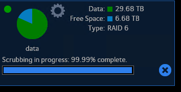

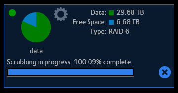

And the scrub is almost done!- LaserbaitJun 20, 2024Luminary
It's a super scrub! 😄
It's probably due to the all the writes/changes/snapshots on the array since the scrub started. But this is getting ridiculous...
