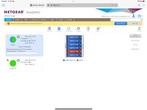

Time to swap out one of my Raid disks? RN 516 (6 bay)
It’s been quite awhile since I last dropped into this forum. Things have been going very smoothly with my RN516 and I have found in the past that your advice has been dispensable. I’ve come across a...

nudist wrote:
can I assume that disk # 5 is unserviceable and needs to be replaced?
Not sure, but the very long time on the resync estimate suggests that you do need to replace it. Your inactive volume message is also a bit unusual - the system seems a bit confused on disk 5.
You could download the log zip file and look for errors. Or just replace it.
nudist wrote:
Do I just turn off the machine and swap it out for a new brand one same specs then restart the machine and wait until the machine has done it’s magic and ready for use?
I always recommend hot-swapping (NAS running), and not powering down. The model and specs don't need to exactly match - so don't go crazy looking for a model that is no longer sold. In general, I recommend NAS-purposed disks (WD Red Plus or Seagate Ironwolf), or enterprise class disks. I don't recommend SMR drives - for example WD Reds. Many 2 TB desktop class drives are now SMR, so I recommend avoiding them.
nudist wrote:
Do I need to wait until the machine has resynced or can I just swap it out regardless of whether it’s finished or not?
You don't need to wait for it to finish.
nudist wrote:
Have I missed anything?
Do you have a current backup of the data? If not, it would be prudent to back it up before manipulating the disks.

nudist wrote:
The disk are relatively new and they are the red label disks.
WD20EFAX? Or a different model? The WD20EFAX are SMR.
- nudistSep 30, 2022Aspirant
2 TB SATA WD20EFRX.
One more question. That fact that this disk reported an error means it shouldn't be trusted even if it can be reformatted and then appears OK. Which means it will probably fail again at some point in the future so best to discard?
- StephenBSep 30, 2022Guru - Experienced User
That's a bit of a judgment call. I do have some disks that have generated a single error that I am still running.
What underlying errors (if any) are you seeing in the log zip?
