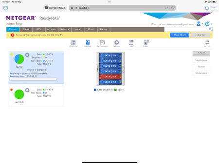

Time to swap out one of my Raid disks? RN 516 (6 bay)
It’s been quite awhile since I last dropped into this forum. Things have been going very smoothly with my RN516 and I have found in the past that your advice has been dispensable. I’ve come across a...

Ive bought and installed a seagate Iron Wolf 2TB replacement disk. Im waiting for the volumes to rebuilt. Because I configured the array for XRAID, Im guessing that at the end the process it will add the new disk to the array and write data to it.
Here the dump of the log file. (If you wondering, I haven't been able to configure the alert message facility to send warnings emails to me)

Sep 30 17:28:11 Readynas516 readynasd[3664]: NAS_SEND_MSMTP_RUN: Fail. (status=1. error_buf=(null))
Sep 30 17:28:11 Readynas516 readynasd[3664]: Could not send email
Sep 30 17:30:14 Readynas516 readynasd[3664]: Detected increasing reallocated sector count: [625] on disk 5 (Internal) [WDC WD20EFRX-68EUZN0 WD-WCC4M1YLZFFP] 21 times in the past 30 days. This condition often indicates an impending failure. Be prepared to replace this disk to maintain data redundancy.
Sep 30 17:30:14 Readynas516 readynasd[3664]: NAS_SEND_MSMTP_RUN: Fail. (status=1. error_buf=(null))
Sep 30 17:30:14 Readynas516 readynasd[3664]: Could not send email
Sep 30 17:32:46 Readynas516 readynasd[3664]: Detected increasing reallocated sector count: [626] on disk 5 (Internal) [WDC WD20EFRX-68EUZN0 WD-WCC4M1YLZFFP] 22 times in the past 30 days. This condition often indicates an impending failure. Be prepared to replace this disk to maintain data redundancy.
Sep 30 17:32:46 Readynas516 readynasd[3664]: NAS_SEND_MSMTP_RUN: Fail. (status=1. error_buf=(null))
Sep 30 17:32:46 Readynas516 readynasd[3664]: Could not send email
Sep 30 17:34:44 Readynas516 readynasd[3664]: Detected increasing reallocated sector count: [661] on disk 5 (Internal) [WDC WD20EFRX-68EUZN0 WD-WCC4M1YLZFFP] 23 times in the past 30 days. This condition often indicates an impending failure. Be prepared to replace this disk to maintain data redundancy.
Sep 30 17:34:45 Readynas516 readynasd[3664]: NAS_SEND_MSMTP_RUN: Fail. (status=1. error_buf=(null))
Sep 30 17:34:45 Readynas516 readynasd[3664]: Could not send email
Sep 30 17:36:29 Readynas516 readynasd[3664]: Detected increasing reallocated sector count: [762] on disk 5 (Internal) [WDC WD20EFRX-68EUZN0 WD-WCC4M1YLZFFP] 24 times in the past 30 days. This condition often indicates an impending failure. Be prepared to replace this disk to maintain data redundancy.
Sep 30 17:36:30 Readynas516 readynasd[3664]: NAS_SEND_MSMTP_RUN: Fail. (status=1. error_buf=(null))
Sep 30 17:36:30 Readynas516 readynasd[3664]: Could not send email
Sep 30 17:41:24 Readynas516 readynasd[3664]: Detected increasing reallocated sector count: [862] on disk 5 (Internal) [WDC WD20EFRX-68EUZN0 WD-WCC4M1YLZFFP] 25 times in the past 30 days. This condition often indicates an impending failure. Be prepared to replace this disk to maintain data redundancy.
Sep 30 17:41:24 Readynas516 readynasd[3664]: NAS_SEND_MSMTP_RUN: Fail. (status=1. error_buf=(null))
Sep 30 17:41:24 Readynas516 readynasd[3664]: Could not send email
Sep 30 17:42:36 Readynas516 readynasd[3664]: Detected increasing reallocated sector count: [885] on disk 5 (Internal) [WDC WD20EFRX-68EUZN0 WD-WCC4M1YLZFFP] 26 times in the past 30 days. This condition often indicates an impending failure. Be prepared to replace this disk to maintain data redundancy.
Sep 30 17:42:36 Readynas516 readynasd[3664]: NAS_SEND_MSMTP_RUN: Fail. (status=1. error_buf=(null))
Sep 30 17:42:36 Readynas516 readynasd[3664]: Could not send email
Sep 30 17:44:58 Readynas516 readynasd[3664]: Detected increasing reallocated sector count: [965] on disk 5 (Internal) [WDC WD20EFRX-68EUZN0 WD-WCC4M1YLZFFP] 27 times in the past 30 days. This condition often indicates an impending failure. Be prepared to replace this disk to maintain data redundancy.
Sep 30 17:44:59 Readynas516 readynasd[3664]: NAS_SEND_MSMTP_RUN: Fail. (status=1. error_buf=(null))
Sep 30 17:44:59 Readynas516 readynasd[3664]: Could not send email
Sep 30 17:47:21 Readynas516 readynasd[3664]: Detected increasing reallocated sector count: [1008] on disk 5 (Internal) [WDC WD20EFRX-68EUZN0 WD-WCC4M1YLZFFP] 28 times in the past 30 days. This condition often indicates an impending failure. Be prepared to replace this disk to maintain data redundancy.
Sep 30 17:47:22 Readynas516 readynasd[3664]: NAS_SEND_MSMTP_RUN: Fail. (status=1. error_buf=(null))
Sep 30 17:47:22 Readynas516 readynasd[3664]: Could not send email
Sep 30 17:50:19 Readynas516 readynasd[3664]: Detected increasing reallocated sector count: [1076] on disk 5 (Internal) [WDC WD20EFRX-68EUZN0 WD-WCC4M1YLZFFP] 29 times in the past 30 days. This condition often indicates an impending failure. Be prepared to replace this disk to maintain data redundancy.
Sep 30 17:50:19 Readynas516 readynasd[3664]: NAS_SEND_MSMTP_RUN: Fail. (status=1. error_buf=(null))
Sep 30 17:50:19 Readynas516 readynasd[3664]: Could not send email
-- Reboot --
Sep 30 17:57:33 Readynas516 readynasd[3734]: readynasd log started
Sep 30 17:57:34 Readynas516 readynasd[3734]: readynasd started. (restarted=0)
Sep 30 17:57:40 Readynas516 readynasd[3734]: Using fan mode: balanced
Sep 30 17:57:40 Readynas516 readynasd[3734]: Volume raid10 is Degraded.
Sep 30 17:57:40 Readynas516 readynasd[3734]: Resyncing started for Volume raid10.
Sep 30 17:57:40 Readynas516 readynasd[3734]: NetworkStats eth0 failed: ERROR: mmaping file '/run/readynasd/stats/network_eth0_pkts.rrd': Invalid argument
Sep 30 17:57:41 Readynas516 readynasd[3734]: NAS_SEND_MSMTP_RUN: Fail.Sep 30 17:57:41 Readynas516 readynasd[3734]: Alert message failed to send.
Sep 30 17:57:41 Readynas516 readynasd[3734]: Could not send email
Sep 30 17:57:42 Readynas516 readynasd[3734]: NAS_SEND_MSMTP_RUN: Fail. (status=1. error_buf=(null))
Sep 30 17:57:42 Readynas516 readynasd[3734]: Could not send email
Sep 30 17:58:16 Readynas516 readynasd[3734]: ReadyNASOS background service started.
-- Reboot --
