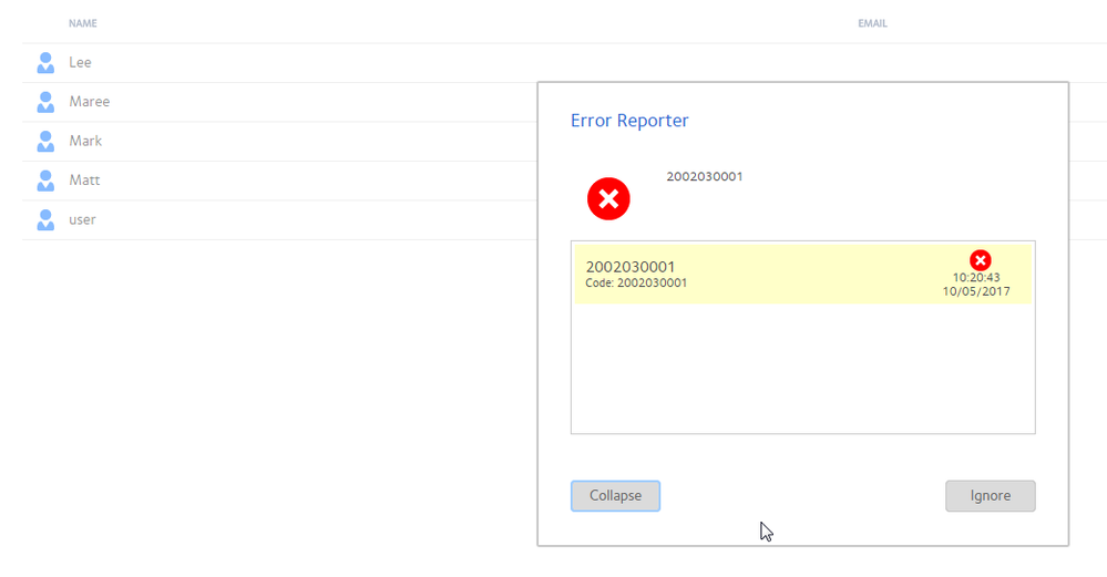

I have tried to change file access but have only been getting errors 2002030001 and 1007130001 when I try as below

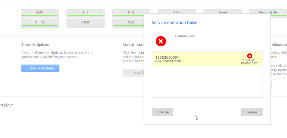

I also tried to turn sharing services like SMB off but also get error 15002030001 doing that
