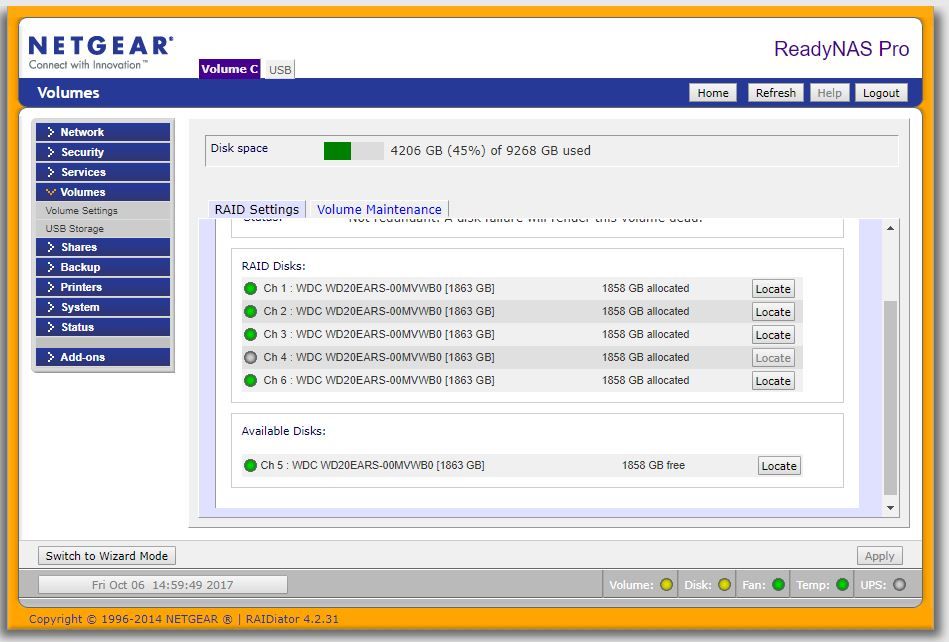

Disk 5 failed so I replaced it with a fresh, identical disk. The resync fails then I get an alert indicating that drive 4 is now dead. I then replace that one with another fresh, identical drive. When it boots up again, the volume is not accessible. I understand why - because drive 5 never fully rebuilt itself.

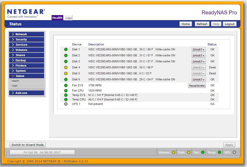

I've put all the original disks back in and now it's showing me that both 4 & 5 are dead...BUT...drive 5 shows up as an available drive outside of the RAID configuration.
This all very confusing to me. Somehow, I am able to access the volume with 2 reportedly dead drives, one of which is outside of the config. I'm actively transfering data to another medium while I still can. Next step for me is to get into the boot menu and try a factory restore on the firmware unless you guys have any other ideas?

    It's pretty clear the NAS is quite confused on the volume status.  Obviously make sure your backup is up to date while you still have access to the data (which might not last).
    A factory reset is the best approach, you could convert to OS 6 while you are at it.
