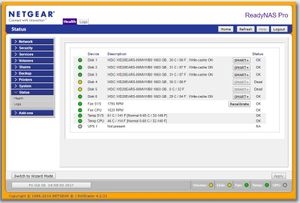

- terry139Oct 11, 2017Aspirant
Everything is finally upgraded and the new Raidar install shows 6 healthy disks. It took a good 3 days to to build after the final OS6 patch.
Now that this is all done, Raidar tires to send me to the admin page where I am met with a setup wizard. I go through the motions and there is an attempt to reach the admin page but it just loops right back to the wizard.
Any thoughts?
