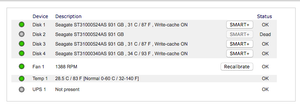

Every step worked and I insterted the new disk back into drive 2 and left last night. Unfortunatly it hasnt resynced. The act light flashes occasionally and drive2 is flashing yellow continually and is reported as dead in frontview.
Not sure what steps to take next, I dont really want to factory reset as don't want to lose data.

I don't think you understood what StephenB suggested. He asked you to insert the new drive alone, after removing all the others with the power off. Then do the factory reset with just that drive installed. The volume on your uninstalled drives will be just fine (though still no longer redundant).
Your picture shows you left the old drives installed.
