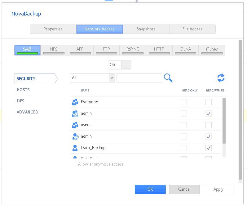

Can you post a screenshot of the network access settings on the NAS?

Can you post the screenshot, and also try rebooting the NAS?
- PeterPJApr 18, 2021Aspirant
I have tried restarting the NAS with no change, here is a screenshot of the network access
