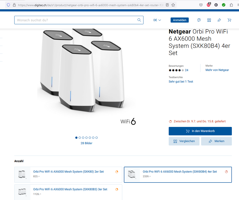

Just checked a large reseller (buying from the official distribution channel) still able to offer virtually "any" amount of SXK80B4, B3, and B2 kits for about 2339 CHF, 1126 CHF, and 823 CHF as of today, for delivery early early June 2024 (B4) or early May 2024 (B3 and B2 Kits). Yes, some 8.1% VAT included, so with a conversion rate of one 1 CHF vs. 0.91 USD, by rule of thumb about 1:1 for simple comparisons.
Five years if Insight Pro included.
No signs of a true EOL here - more End-of-Manufacturing and End-of-Sale how more business oriented vendors are naming it.
