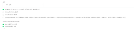

Rax38 v2, latest firmware 1.0.16.132 has critical bug, Region selection was disabled
내 라우터(Rax38 V2)를 1.0.16,132로 업데이트했을 때 지역 선택이 비활성화되어 설정이 불가능했습니다. 설정을 저장하려고 하면 '지역을 선택하세요'라는 메시지가 나타납니다. 위에서 말씀드린 것처럼 지역선택이 비활성화 되어 있어서 설정이 불가능했습니다. 사진을 한국어로 올려서 죄송합니다. 상단에 지역선택이 있...

whem i updated my router to latest firmware, 1.0.16.132
the region selection was disabled
when I tried to save my setting, but message appeared " please select a region"
But as I said above, region selectiom disabled, so i can't complete my setting
Resetting the router didn't solve the problem
However, it was resolved by downgrading to the previous firmware.
I want to use the latest firmware because of security issues, but it seems to have bugs.
Is there a way to report this issue to the Netgear firmware team?
Sorry for attaching a screenshot in Korean.
The first part is the region selection part. That part disabled. and fixed to ------ select region ----------
