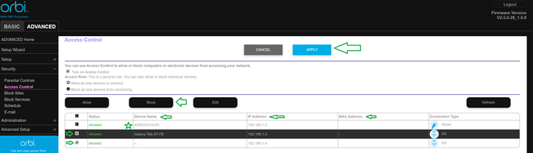

Configured the following by using the "All Devices" option.
I have my wired management PC, Android pad and iPhone. Both had the MAC address randomizer enabled for this test.
Check mark the devices that you seen that need to be controlled. Be sure to leave your management PC (green star) and any allowed or authorized devices un-checked so you don't block these.
After you have the selected devices checked to be blocked, select the BLOCK button, then select the APPLY button.

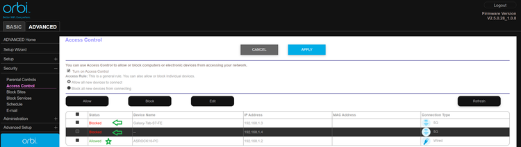

The status should change to BLOCKED on this page.
I checked my two test devices and though they were connected to the signal, they had ZERO internet access. I check this by trying to access the CBRs web page on both and could not get to the CBRs page. Even when I configured the faux AP mode on the CBR and connected behind my main host router. The one PC had internet, the two wireless devices did not.
