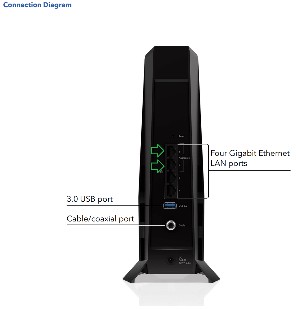

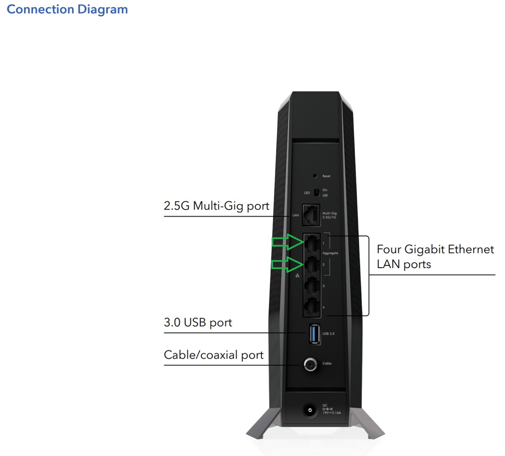

NETGEAR CM1100 and CM2500:

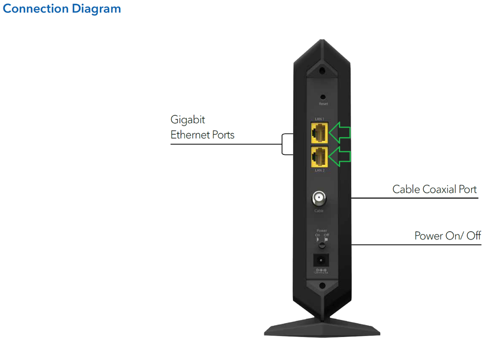

NETGEAR CM1200:

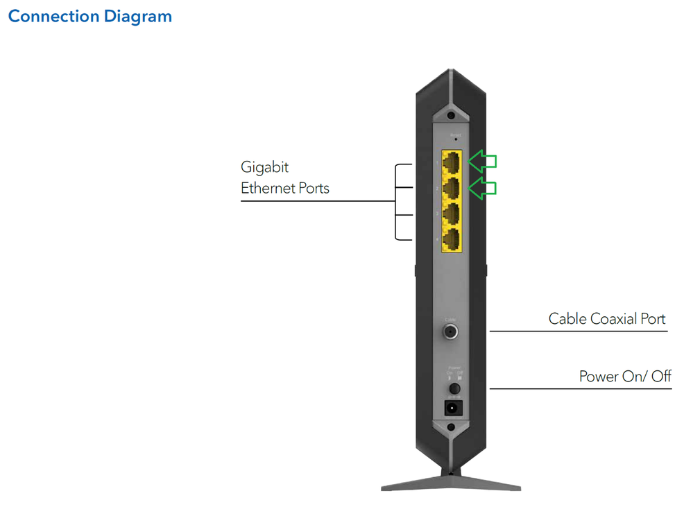

NETGEAR CM3000:

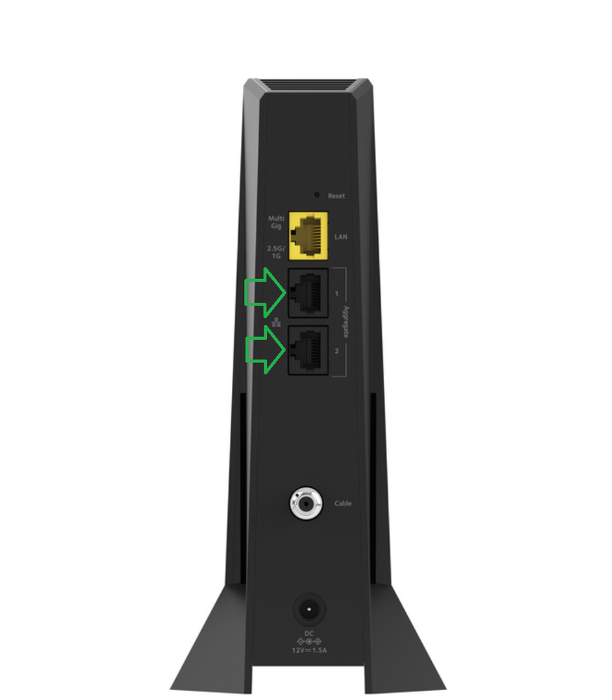

CAX30:
CAX80:

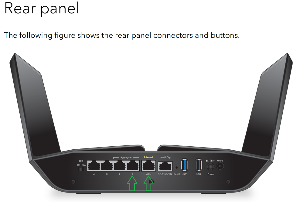

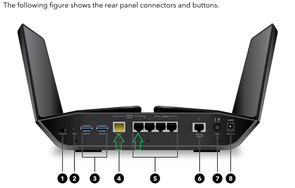

Rear Ethernet Port Identification for NETGEAR RAX120 and RAXE500 router systems:

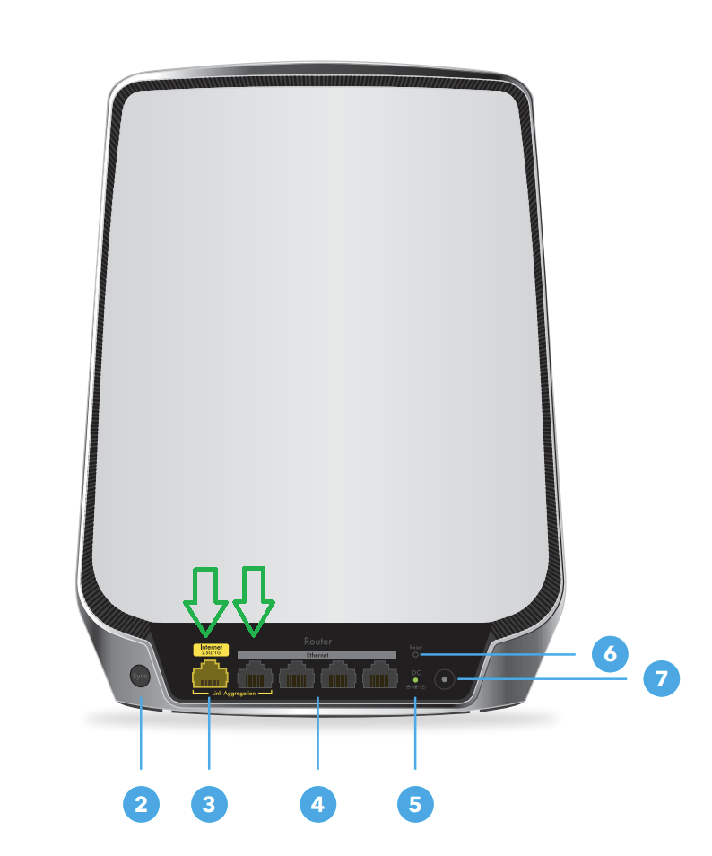

Rear Ethernet Port Identification for Orbi RBR850 router systems:

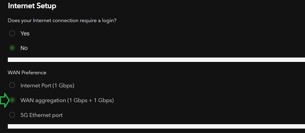

Navigate to Advanced tab/Setup/Internet.
Under WAN Preference, select the small round button next to WAN Aggregation (1 Gbps + 1 Gbps)
Select the APPLY button at the bottom right side of this web page to apply and enable this feature on the router system.

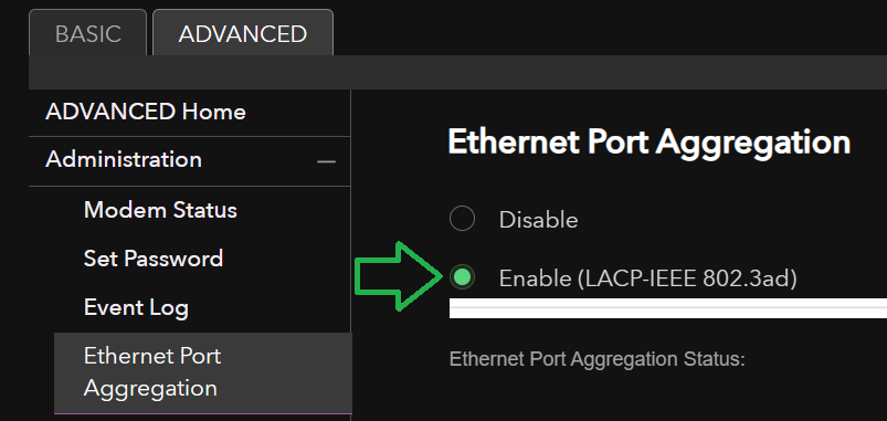

Navigate to Advanced tab/Setup/Administration/Ethernet Port Aggregation:
Select the APPLY button at the bottom right side of this web page to apply and enable this feature on the cable modem. Take notice of the front LEDs on the cable modem as the modem may reboot soon after you select the APPLY button.
As the modem is rebooting, connect two ethernet cables between the cable modem ethernet WAN Link Aggregation ports and the router system ethernet WAN Link Aggregation ports as identified from the above pictures. Ethernet Port 1 on the back of the cable modem connect to the ethernet port marked INTERNET on the router. Ethernet Port 2 on the back of the cable modem connect to ethernet marked LAN Port 1 on the router. CAT6 is recommended for both cables. Do not mix CAT# version cables.

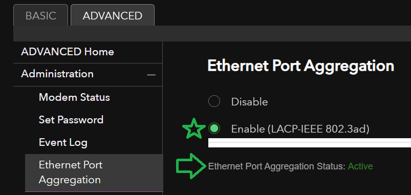

Ethernet Port Aggregation Status should display Active in GREEN. This means the Link Aggregation connection between the cable modem and router is good and working.

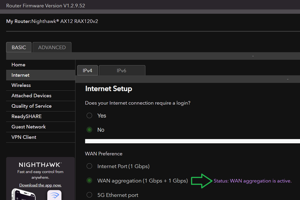

Navigate to Advanced tab/Setup/Internet:
Under WAN Preference for WAN aggregation (1 Gbps + 1 Gbps) the status will display WAN aggregation is active. This means the Link Aggregation connection between the cable modem and router is good and working.

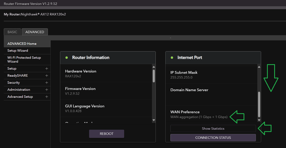

Check and Verify the router INTERNET port and Show Statistics
Log into the router systems web page using the admin credentials using a web browser.
Navigate to Advanced tab.
One the Internet Port section, scroll down to the bottom of this window:
Wan Preference should display WAN Aggregation (1 Gbps + 1 GPBS).

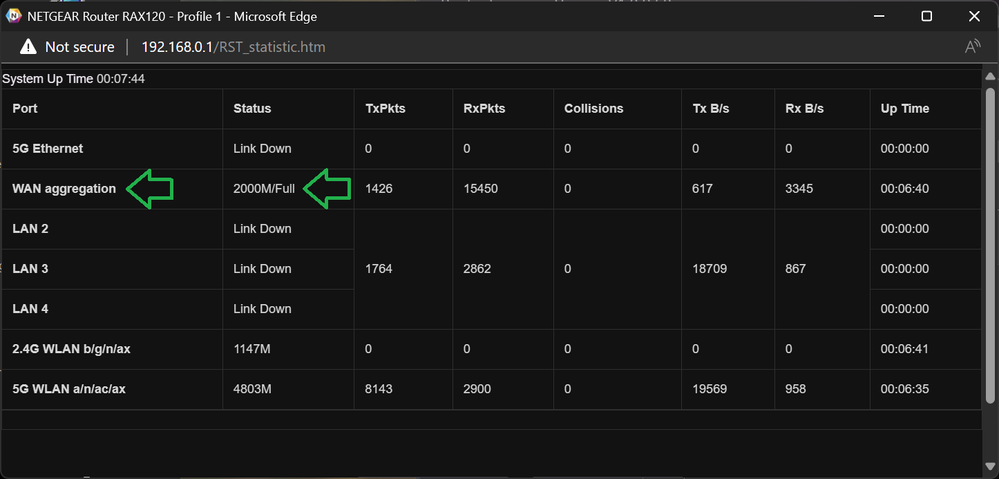

Select the Show Statistics button:
Under Port and Status and review WAN Aggregation and the speed seen under the Status column. 2000M/Full will be displayed here.
