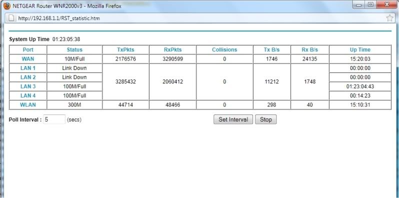

just checked in my router statistics page n teh WAN speed is 10m/full !!!!
surely this router cannot just be 10meg onteh WAN side ??
if so its going straight back to the shop

theTechman05
Re: wnr2000v3 capping me at 9mb !?!
Anyone notice his picture that the wan port is listed at 10M and the lan ports are 100M.
Time to look for a higher router. I though when I first read this you had a cable router and not 2 separate items.
