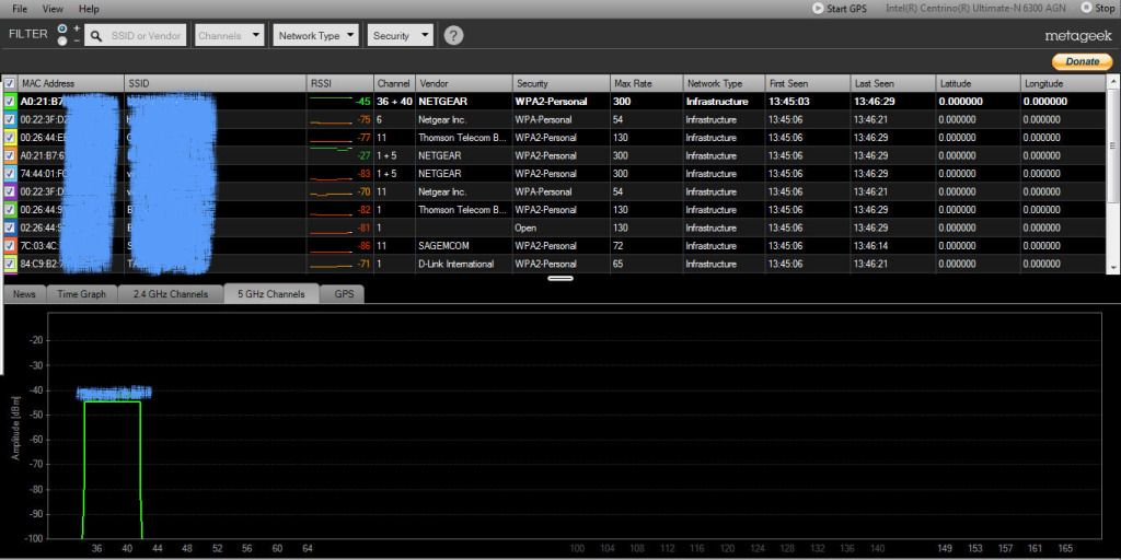

I don't know why you are unable to see your own router's SSID, but here is a quick guide to the three main screens that will be of interest. I've covered over the MAC Addresses and most of the SSID names for security reasons.
This image shows the 5GHz channels. As you can see, along the top is all the visible routers. The one I am connected to is in bold white. My 2.4GHz SSID carries the same MAC Address at first and is 4th in the list.
From this image it is clear that no one else close to me is using the 5GHz frequency. Smiley Happy
My other Laptop will show the 5GHz screen, but since the installed adaptor doesn't work on the 5GHz channels, it remains blank.

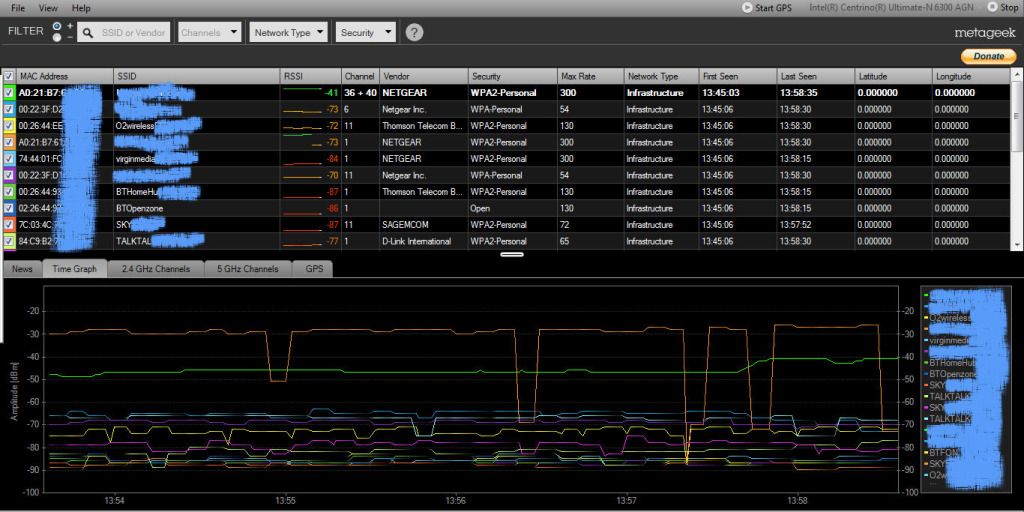

This third and final image shows the signal pattern. Although the 2.4GHz spikes on my own router's signal, this is something I have noticed on the WiFi Adaptor I have installed in this Laptop. When connected to a 2.4GHz channel, I don't get those spikes on it. My other Laptop works just fine on 2.4GHz only.
The fading lines indicate that those signals are too weak for me to connect to.
I have found that the actual reported signal strength will vary according to which adaptor you are using and the angle which both the router and Laptop are relative to each other.
