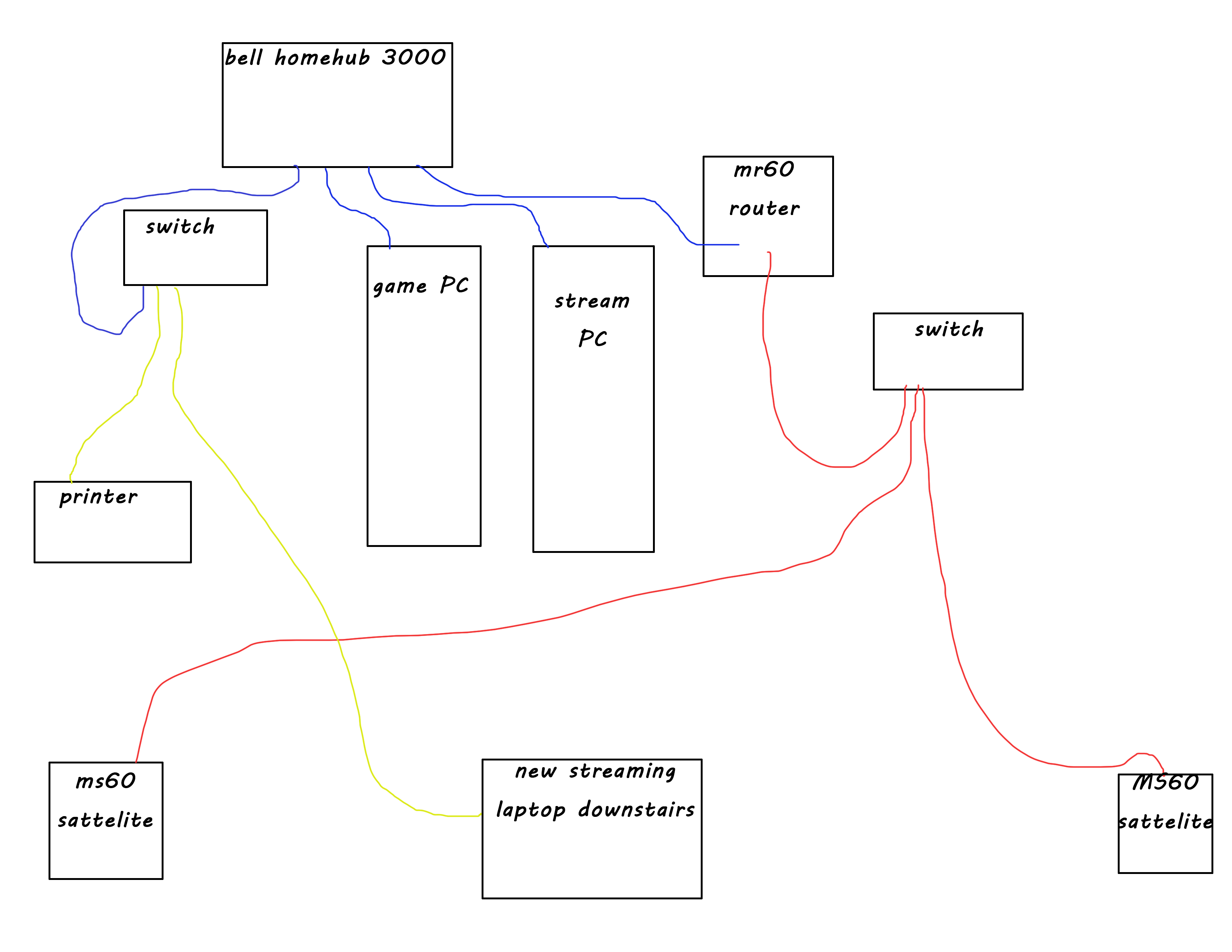

Re: weird non-connection issue with MK60 mesh system
so someone from one of the IPcmas apps ive been trying to use sent me this after a little back and forth -
"Hi,
it looks like your Ethernet and WiFi are not routed together, that's why you can't reach the phone.
The mask is probably 255.255.255.0 and you can't reach 192.168.1.x from 192.168.2.x.
There's a missing configuration somewhere in the router that should act as the gateway and find the path from a network to the other.
Is your PC's network configured in DHCP? Is the gateway specified?
On the phone I guess you are working in DHCP, that is the 'normal' WiFi configuration in Android, If so, the gateway is set automatically.
To check the connection, please open the terminal 'cmd', then enter the command 'ping 192.168.1.23'."
is that enough for anyone to help me?
and here is my network (minus the wifi connections which are many)
