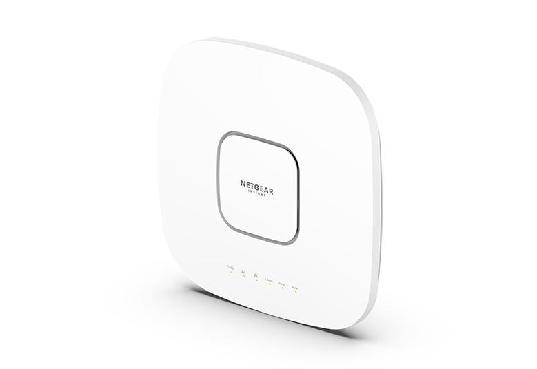

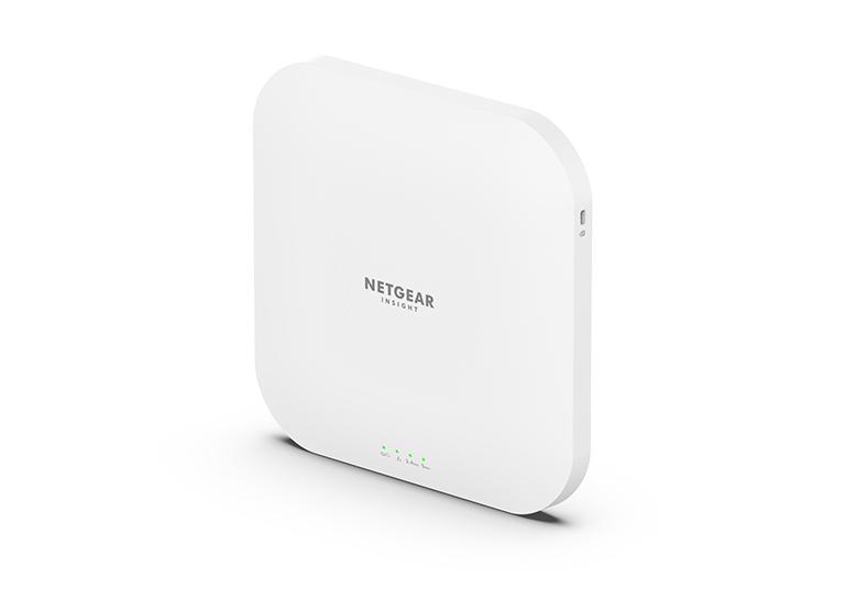

I’ve figured out what is happening, i’m setting a static ip address (192.168.0.100) in the RAXE500, but the router randomly changes it. I have WAX620/AX3600 and WAX630/AX6000 set up in access point mode with static ip address and they do not have the same problem.
Routerlogin.net works in access point mode on WAXE500.  I’m guessing when the ip address falls outside by network it no longer is reachable. But routing to devices on REXE500 still works…
