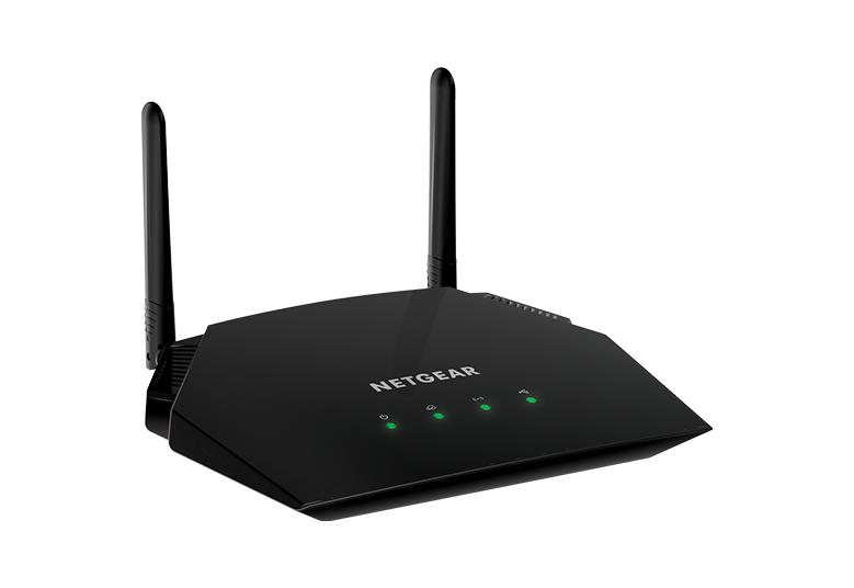

Re: Routers not recognizing DNS changes
Thank you again.
I'm attaching a screenshot of my router settings. Is the box I've drawn for DNS Address what you're referring to? Right now it's set to "Get Automatically from ISP".
If I set Primary DNS to 8.8.8.8 or 1.1.1.1, that will clear this up? I want to double-check before potentially making the wrong move.
Thanks!
