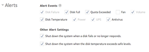

Now that all our backup jobs are working properly, our 104 is on a nightly power timer. Is there any way to turn off the daily "The system is shutting down." emails I'm getting now? The check box for this is grayed out: I want to keep getting email alerts but don't need a daily reminder that the power timer is working properly. Any suggestions? Thanks!Solved1.9KViews0likes3CommentsFW 6.4.1 Problems: Power Timer not working
