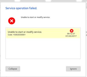

Hello Community, my AFP Service suddenly stopped. How do I get the AFP service working again?? Stopping and Starting the service in the Browser Interface of ReadyOS gives error: Unable to start and modify service (error code: 15002030001) I even tried to reinstall OS i.e. I installed the 6.8.0 Beta - but still the same error and unavailability of AFP as before. the AFP log also shows errors (see below) - but I don't no any further measures to get the service working again. I need AFP working for MacOS TimeMachine Backups. Ideas and help greatly appreciated. NAS-SAN-NAS Sample of the Log-Download: AFP: Jul 20 21:12:55 nas[Nas-Name] afpd[28455]: transmit: Request to dbd daemon (volume [username]'s home) timed out. Jul 20 21:12:55 nas[Nas-Name] afpd[28455]: afp_openvol(/home/[username]): Fatal error: Unable to get stamp value from CNID backend Jul 20 21:12:55 nas[Nas-Name] afpd[28455]: AFP logout by [username] Jul 20 21:12:55 nas[Nas-Name] afpd[28455]: dsi_stream_read: len:0, unexpected EOF Jul 20 21:12:55 nas[Nas-Name] afpd[28455]: afp_over_dsi: client logged out, terminating DSI session Jul 20 21:12:55 nas[Nas-Name] afpd[28455]: pam_unix(netatalk:session): session closed for user [username] Jul 20 21:12:55 nas[Nas-Name] afpd[28455]: AFP statistics: 0.73 KB read, 0.62 KB written Jul 20 21:12:55 nas[Nas-Name] afpd[28493]: read: Connection reset by peer Jul 20 21:12:56 nas[Nas-Name] afpd[28493]: read: Connection reset by peer Jul 20 21:12:57 nas[Nas-Name] afpd[28493]: read: Connection reset by peer Jul 20 21:12:58 nas[Nas-Name] cnid_metad[28846]: Multiple attempts to start CNID db daemon for "/data/Documents" failed, wip5.2KViews0likes6CommentsFile access confusion with afp and smb
