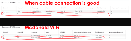

Does anyone know what would cause this difference on Channel 2? When I had a poor downstream connection last year I put the Attenuator (screenshot attached) on the cable that plugs directly into the CAX30 because my power levels were too high. That worked until now, and I noticed that Channel 2 looks like the channel id, frequency, power, etc. should be 0. Took the Attenuator off and it makes my power levels too high like the original problem last year. Anyone see this issue before or know off hand what could be causing this? I've been trying to copy the Cable Diagnostic info but I'm getting "refused to connect"Solved2.4KViews0likes4CommentsCable Modem Shut Down

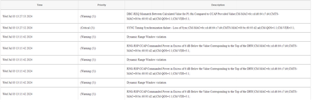

I'm having issues with being able to receive good a good WiFi connection in my bedroom. I currently have a nighthawk cm2000 modem connected to a Spectrum router model (SAX2V1S). I do not have the biggest apartment so I'm wondering what could be causing this to have a poor connection? I have a buddy that just keeps mentioning to look for the best modem settings and to change them on my end. I have looked but have not found any answers to this. I am also not very knowledgeable when it comes to these things. It was suggested to implement a WiFi extender but i am curious to know if that is really needed. Any sort of help will be appreciated. I have provided an event log since it seems that's what a majority of people do. Firmware is V1.01.06.976Views0likes1Comment
