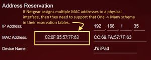

I use an XR700 router with a EX8000 extender. They were expensive and I hope that they would provide my household a few more years of service. I want to use TP-Link Smart Plugs (Kasa brand) because TP-Link offers great control API's. I need to get confirmations about on/off events and either retry or alert if there is a problem. This plug runs a pump, so it is important for my home automation to have certainty on plug events and status. In order to use these devices and API's, all I need is a fixed IP address for the plug. Easy, right? Huh! I have heard others folks here with similar requirements for knowing a device's IP address and they have been struggling for longer than I have with the history: Netgear, along with a few other companies, broke the 1:1 association between the physical interface and a MAC address in order to improve WiFi extender performance. They introduced the Virtual MAC addressing. The problem is that Netgear has not updated their router logic to accommodate this new 1:M schema and it has remained broken for years. As smart devices and control mechanisms proliferate, Netgear will need to fix only one thing to allow these smart objects flourish within their networks, a second MAC address for one IP address: I honestly believe that these services will only support dumb homes until this self-inflicted wound has healed. The logic required for this firmware update is not so expensive to produce. NETGEAR, please do it to keep your products and networks on-line and your customers happy! I notice in DumaOS, that a "client device" can be listed with multiple MAC addresses. So, there must be some logic that supports a 1:M schema at least by "device name" that might be formally defined an extended to the reservation table structure:2.1KViews0likes12Comments
