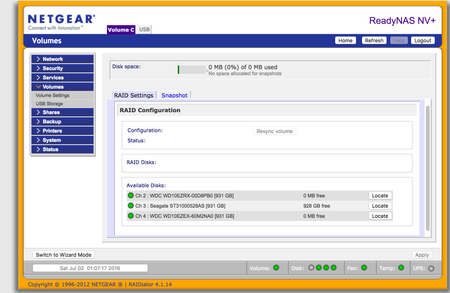

Came home from vacation only to find my NV+ v1 frozen. Tried to unplug and reboot, and it and nothing. Disk 1 was making noise, and I read that sometimes if disk 1 went out you would need to replace that before it would boot. Got the new drive in yesterday, replaced it, and no boot. Next step was refreshing the OS, so used the reset button on the back to do that. After that didn't work I tried putting drive one back in, and replacing one drive at a time with the new drive I had just purchased. Still nothing. Went back and swaped out drive 1 again with the new drive and this time it booted, but was still telling me I had a dead drive on the frontview. Once I was able to get fully booted it showed the following.. Slot 1 - no drive Slot 2 - 0mb free Slot 3 - 928 gb free Slot 4 - 0mb free Looking at the logs it seems that drive 4 had been failing but for some reason I never got the email notifications. I am afraid that I've lost my data..... Any ideas?2.8KViews0likes5CommentsReadyNas NV+ Development > Questions (Regarding: Frontview / Device Source Code)
