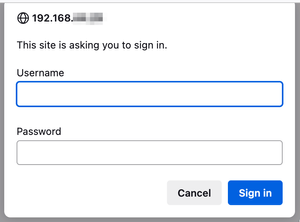

For nearly 10 years I'm a happy user of my GS105Ev2. Now I want to log into the UI again, but (of course) did not remember any credentials. I've reset the switch by pushing the reset button with a paperclip for more than 2 seconds. After a while I realized that the user manual is talking about only a password while I'm asked for a username ánd password via the browser (not sure, but I think this is because of basic authentication where is asked for by the web-server of the switch). What is going on here? When using curl or Postman I get the following response: <html><head> <title>401 Authorization Required</title> </head><body> <h1>Authorization Required</h1> <p>This server could not verify that you are authorized to access the document requested. Either you supplied the wrong credentials (e.g., bad password), or your browser doesn't understand how to supply the credentials required.</p> <hr> <address>Web-Smart Server</address> </body></html> I already have done the following: - double checked the IP address of the switch i.c.w. the MAC-address multiple times; - tried the default credentials: admin/password; - tried to access the switch using both ways of connecting to the switch as described in the user manual: 1) via router using DHCP etc.; 2) directly using static IP address on laptop etc.; - searching for the switch using the Netgear Switch Discovery Tool, but it doesn't find anything. For all this I used a Apple Silicon MacBook and Firefox. Does anyone has suggestions left?Solved2.7KViews0likes4CommentsGS316 Unmanaged Switch Not Providing Internet
