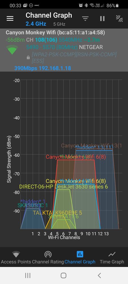

      • CanyonMonkey's avatar
        CanyonMonkey
        Tutor
        I turned off the guest Wifi. this channel graph I'm sharing is pretty much 'car crash' stuff for 2.4Ghz wifi. I can't do that to my neighbours.... Interestingly, it seems that one of my devices has moved to ch11, with the other two on ch8.

    • CrimpOn's avatar
      CrimpOn
      I have serious doubts that this actually "works".  Do you have access to a WiFi channel analyzer, perhaps on a laptop or Android device (phone, tablet)?
      When I open WiFi Analyzer by Kevin Yuan on my Android devices, it clearly shows the access point MAC addresses for my router and satellite, both on the same channel.  When I change the channel on the router, the satellite changes along with it.
        CanyonMonkey
        Tutor
        Despite your "doubts" I can confirm it "works".
        Screenshot attached of each device running a different 2.4Ghz channel. I've also logged in and confirmed via the interfaces that each is running on those channels.
