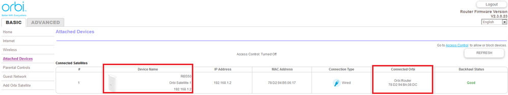

  • In the web GUI (orbilogin.com) you will see a list of all your satellites and if these are connected to the router in star topology or to other satellites in daisy chain as follows:
    You can also see the same information in the Network Map in the Orbi app.
    If you have Daisy Chain enabled then each satellite will have the option to connect to the router or to one of the other satellites depending on the level of the backhaul signal received by the satellite from each of those nodes.
    If Daisy Chain is disabled only the router will broadcast the hidden backhaul network, while if Daisy Chain is enabled all satellites will also broadcast the hidden backhaul network.to allow other satellites to connect to.
