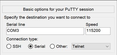

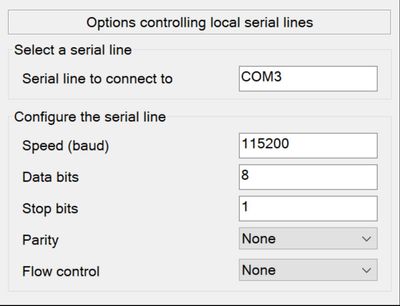

These are the current serial settings in putty. (I've also updated the speed for the com port in device manager as well)

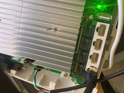

PIN Connections to the RBR50

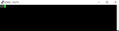

Putty screen when the connection is opened.
Whenever the connection opens and I turn on the router, absolutely nothing gets printed to the screen. When I turn off the router, 1 or 2 of those characters shown in the screenshot gets printed. If I turn back on the router nothing is still printed to the screen. Turning it off just prints more characters to the screen.
Many people say that they see the router info being printed to the screen, but I'm clearly not. I'm not sure what else to do other than buy another usb to ttl cable and try again.

I found that on some diagrams posted out there, the TXD and RXD pins are incorrectly labelled, and as a result, when you connect them, Putty gives you a blank screen.
Swap the TXD and RXD wires and you should get a result - make sure the GND wire is correct though !!
