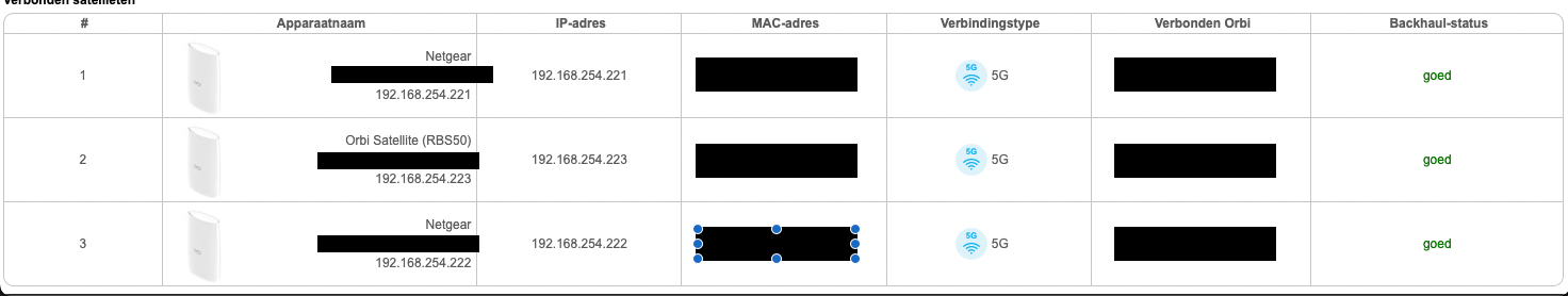

Hi, again some troubles. I have resetted all the devices to factory defaults, router en satellites. The RBR-50 is up and running in Access Point mode and 2 out of 3 are connected, at least, according to the orbi app on the phone. When I login into the router via the browser, I do see all 3 the satellites.
When looking further there is a mismatch in the ip address in the phone app, it is showing an old ip address and the browser is showing the new, correct one. I have included 2 screen prints. I have rebooted the router, but nothing helpes.
Another issue is that 2 of the 3 are wired connected, but as shown on the screenprint, they are connected wireless. Next to this, I wonder why the names of the devices differ in the browser, 2 out of 3 are called "Netgear" and the third, currently not working one, is named "Orbi Satellite RBS50) and the satellites are all the same.

Thanks, I have updated the firmware a few hours ago, but it is still not working 100%. A wired RBS50 is still on 5G and another RBS50, with the same setup, is working over wired. I have no clue why the first one is not able to connect as a wired connection.
