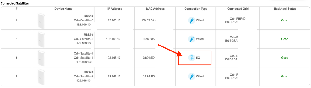

  • I forgot to include a screenshot showing the Orbi Web UI and the solid backhaul connections over the wire. I used some white blocks to hide MAC addresses and parts of IPs, but it's otherwise unaltered.
    It's attached, and linked here: Orbi router web UI showing wired backhaul

    I took the 2nd RBS20 out of the box and tested the wired backhaul and then updated to the latest firmware for the unit.
    I re-enabled daisy chaining under Advanced Settings in the Web UI.
    Incidentally, I had a browser message pop up warning me that the Orbi UI only allows one concurrent user login to the app. I was on my iPad in Safari and was using the web app on my iMac at the same time.  I point that out as a nice security feature that is enabled by default.
    Finding that was kinda like figuring an easter egg in a new version of Android. :-P
    Anyway, after a sucessful upgrade, I rebooted the RBS20 and it wouldn't connect via wireless to the router that was 15 feet away. I ended up resetting the RBS20 twice. The first reset was because I was impatient. These devices take a long time to get fired up. Upwards of 10 minutes in my recent experience. I reset it a 2nd time because the unit kept flashing magenta, and again, I wasn't patient enough.
    Finally, I went for a 20 minute stroll and when I got back, the RBS20 was sync'd at 5 Ghz!
