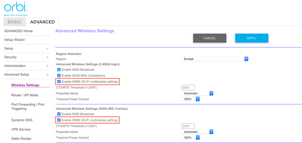

1) This is an indication of bad throughput or packet latency:
- WMM is active by default, but please check that it's ticked for the 2 bands as below:
2) My speaker which is just on the back of the router selects always the 2.4 GHz band probably since it's too close. Let's try -for test purpose only- to force your camera to the 2.4 GHz band and see how it behaves, please try the power reduction on the 5GHz instead and then power recycle the camera hoping that it will select the 2.4 GHz band now. :)
