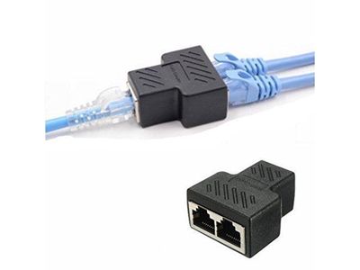

    You "split the line". What exactly do you mean? you can't just split the line. you actually need a switch to do something like that. Is that what you did?

      Ethernet Splitter Adapter -
       The single end has the cat5 cable from the modem/router at the house and each of the other go to the cameras respectively. Isnt this the same concept as a switch? (I do have a switch but it seems to disrupt the connection/overload the system when I have it plugged in??)
      Does the switch give each camera an access point where as the splitter adapter does not?

    Because of the metal wall (which will probably block WiFi signals), each camera needs a separate connection.
    If the cameras have Ethernet ports (which many cameras do), then what you need is one inexpensive switch connected back to the main building plus one Ethernet cable to each camera.
