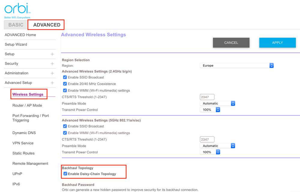

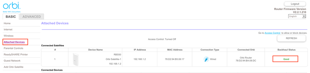

1. Please connect to Orbi using a browser on your computer by going to orbiligin.com.
Go to "Attached Devices", do you see your Satellite there? If you see it as "Disconnected" you should see a button beside it saying "Forget" or something similar. Please click that button and try the "add new satellite" procedure again.
2. Please check the Daisy Chain settings in your router by going to >> ADVANCED >> Advanced Setup >> Wireless Settings
Please toggle this setting and see if that will help
Good luck :)

Dec 15, 2018Virtuoso
