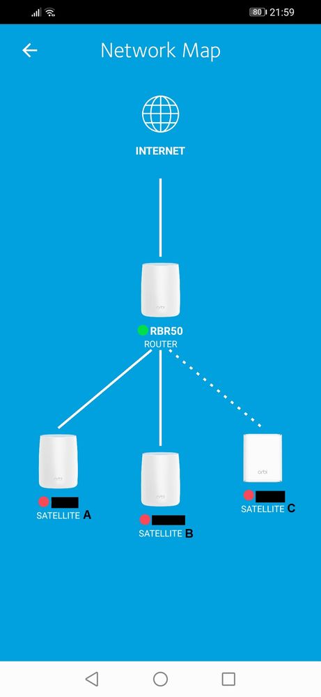

The Orbi App, however, shows as they are all disconnected (please ignore the satellite C - RBS50Y):
Despite this (that is annoying), I can't have local access to a network resource if it is in a different satellite.

    I waited for the weekend and did a factory reset in all my Orbis (RBR50, RBS50 and RBS50Y).
    Everything now is showing online (Orbi App and Orbi's web administration console).
    I can even check for new firmware update through the Orbi's web administration console.
    The only thing is my RBS50Y shows firmware update failed after check is done (but there is no firmware update to do at the time as it is running the 2.6.1.40 version).
