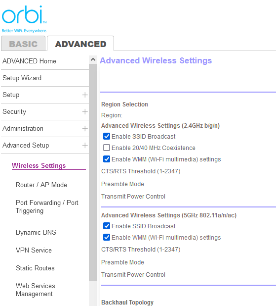

Navigate to the Advanced Tab, Advanced Settings (bottom item), Advanced Wireless Settings.
Notice that the option Enable 20/40 MHz Coexistance is checked. (Here on my Orbi it is not checked.)
Enabling this option allows devices to bond two 20MHz channels together to get higher throughput. However, when a device that is capable of only using a single 20MHz channel is active, the entire channel constricts to 20MHz and devices that are capable of using the full bandwidth are not allowed to. I find it very confusing to read about:

- CrimpOnJul 22, 2022Guru - Experienced User
p.s. On my Orbi, the channel changes either way. Takes bloody forever to do so, but it does change.
