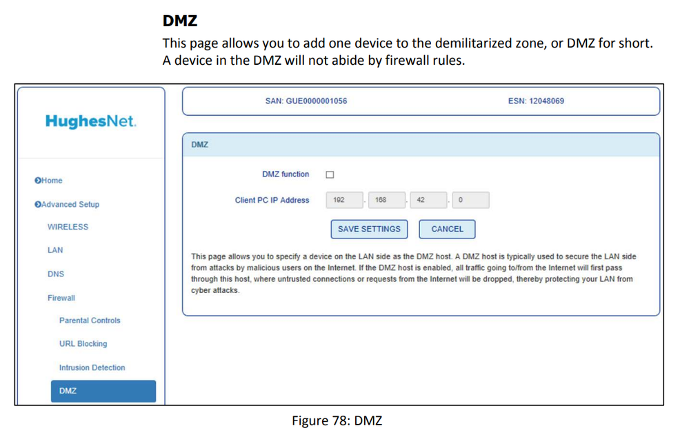

We have the HughesNet modem HT 2000W. TP Link was set as router, as was the Orbi. And everything but Outlook 365 worksEven if you did not have issues before Orbi, you still have double NAT and most likely you will get issues with some applications.
In the manual for your router I could find the following settings which can mean bridging the router:
Do you have access to the ISP router?
The router also has DMZ mode that you also can use as an alternative:
