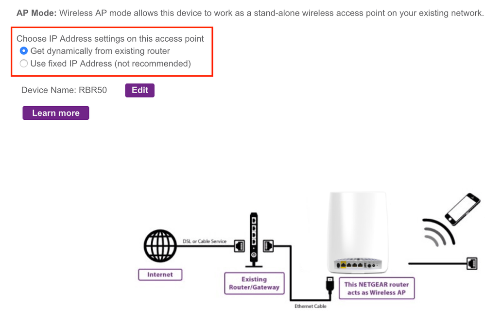

When you set Orbi to AP mode you get a question about IP addressing responsibility as follows:
1) Depending on what you selected, Orbi will direct all Attach requests from devices to the router or not. Please check this setting
2) Is the DHCP server address defined in your router?

When configuring AP mode I selected the first option "Get dynamically from existing router".
