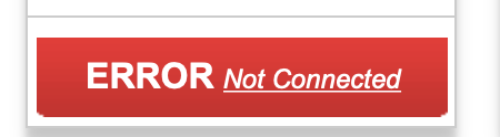

I can't understand why this isn't working.. In my orbi router as AP mode I set the IP to 192.168.1.2... I have ran this command and a phantom IP is appearing  config get ap_dhcp_ipaddr 192.168.1.214 -- This IP doesn't make sense. The IP of my DHCP server should be 192.168.1.1 - This is the Optimum modem / router combo. I am pasting the commands I ran. The only thing that doesn't make sense is the 214 IP.. Please help because im getting not connected error in the interface / waiting / detecting & I don't know how to fix this.

    It would be useful to have more detail about the error message.  Is this a smartphone app?

      The IP address pool is 192.168.1.30-254 the optimum router doesn’t see anything on 192.168.1.2. I notice that if I reboot the whole system. The satellites all stay on up 192.168.1.250. If I access that website in a browser it’s random which satellite it connects to. Meaning it’s like flip flopping between them.
