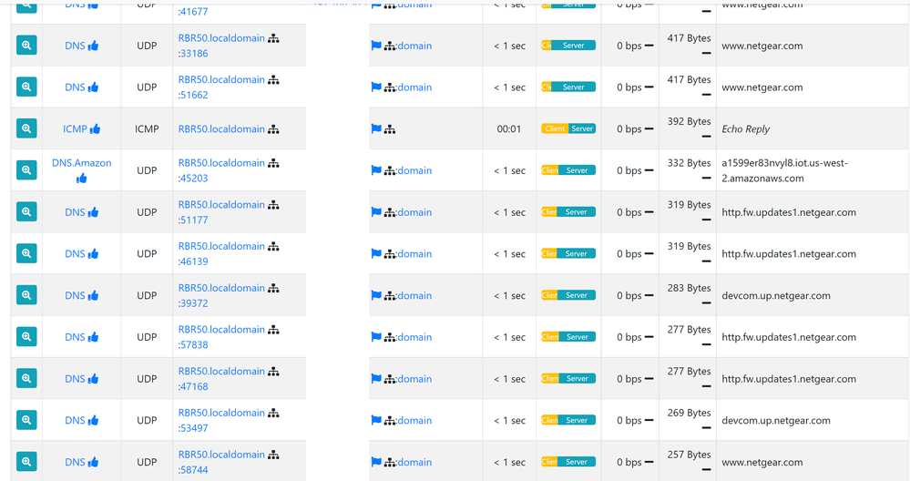

  • I scanned some domains' netgear.
    http.fw.updates1.netgear.com,
    time-e.netgear.com,
    e70.g.akamaiedge.net,
    www.netgear.com,
    netgear.com,
    devcom.up.netgear.com,
    registration.ngxcld.com,
    netgear-devrecog.fing.io
    If you use pfsense, you will create alias and create rules on WAN tab then block Router & Satellite IP access Alias. See picture below.

        So that I scanned some domains which the router and satellite access.
        When you go to Advanced - Administration - Firmware Update. The router will access to devcom.up.netgear.com, a1599er83nvyl8.iot.us-west-2.amazonaws.com, www.netgear.com
        When using NG's ntp server, it will connect to time-e.netgear.com
        The "cached" domain a1599er83nvyl8.iot.us-west-2.amazonaws.com can change anytime they want. That is the reason I list some domains.
        If we use pfsense, we can block only .*netgear.com, .*ngxcld.com for all subdomains. And e70.g.akamaiedge.net
        I tried to update voxel's firmware, the router access to this domain: netgear-devrecog.fing.io
