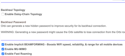

Hello,
I have an issue with poor connection in my backhaul specifically with an RBW30 add on satellite.
My configuration is as follows:
- RBR50 Router
- RBS50 Satellite
- RBW30 Satellite
(The configuration is the router in a kind of 'L' formation with the router at the elbow of the 'L')
With the daisy chain update I had assumed that the connectivity would be better improved because it would pick the best backhaul. What I found is that it consistently kept switching the backhaul so the RBRW30 Satellite was alwasy unstable.
So I've tried to turn off daisy chaining (which reboots the entire system) - and for some strange reason it is still daisy chaining

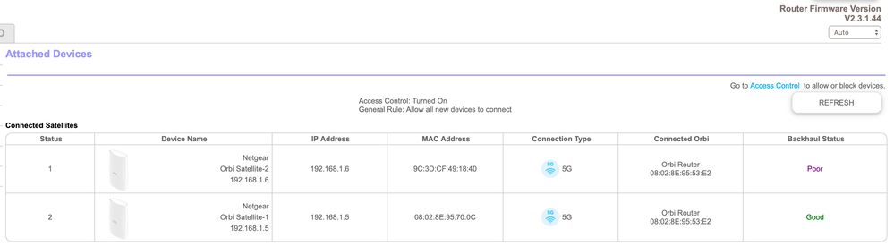

You can see my version (V2.3.1.44) and configuration in the screenshots above.
Any recommendations?

With the RBR at the elbow of the L placement configuration, Daisy Chain will be of no benefit and will not work in this kind of placement configuration. If the RBR was at the head or tail of the L configuration, then maybe DS would work.
Try a factory reset on the RBR and setup from scratch. Ensure DS is disabled before bringing on the RBSs.
The attached screen shot show both satellites connected to the router, i.e. NOT a "Daisy Chain" (which means the router is connected to one satellite and the second satellite is connected to the first one.)
Something about the placement of the satellite is resulting in poor signal between it and the router. The RBW30 is designed to plug into a wall outlet. Those are often close to the floor and behind furniture. Could be metal appliances in the path. Is this RBW30 actually plugged into the wall? What happens when it is plugged into an extension cord and moved to different locations?
