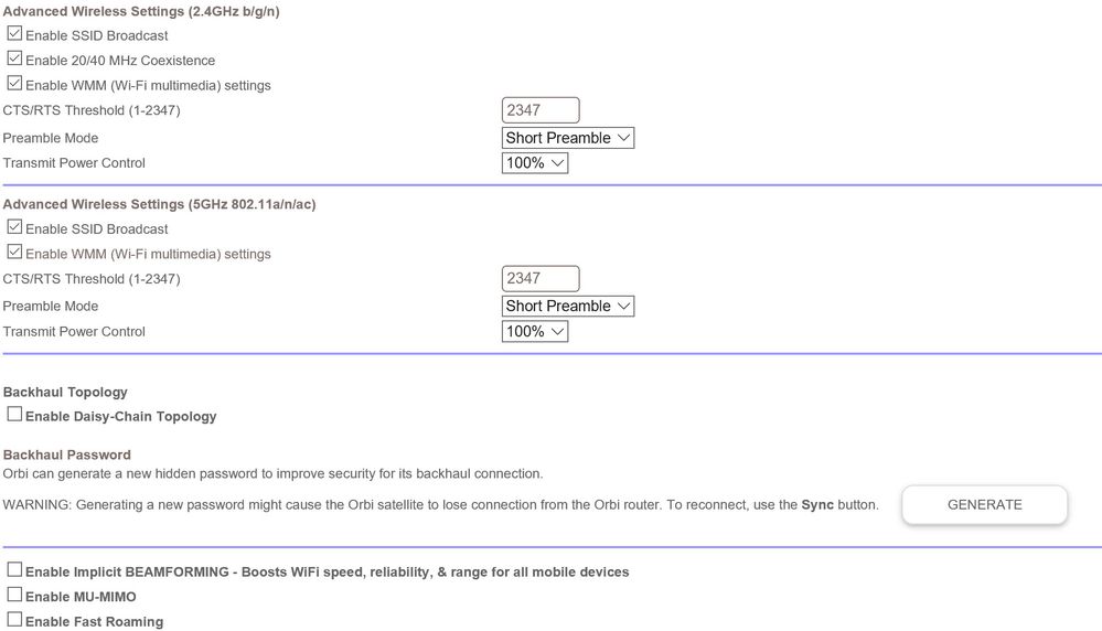

config:

  • FURRYe38's avatar
    You can test with Beamforming, MIMO, Daisy Chain and Fast Roaming disabled and see if anything helps. I've disabled all of these and has helped in most configurations.
    Currnet versions of FW aren't the greatest and everyone is waiting on the next update.
    It's recommended to connect game consoles via ethernet for best gaming performances.
    • wolfbow's avatar
      wolfbow
      all of them are disabled and ethernet isn't a great option. thanks for the reply.
