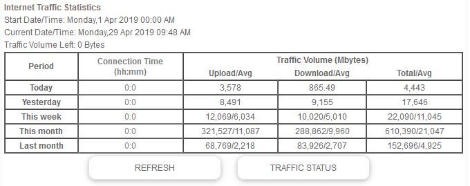

    It does appear to be working as expected with the latest firmware, or close enough within fault tolerance. Monthly, Yesterday, and Today records seem to fall within acceptable expectation.
    April:
    Orbi - 610GB

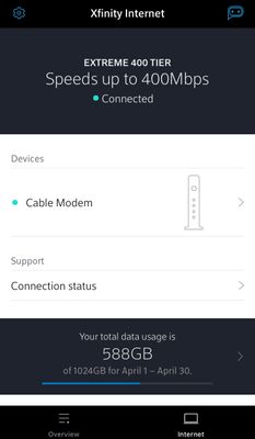

    ISP - 588GB

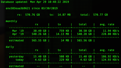

    Tap - 540GB
    I expect the Orbi to have the highest record since it should actively track every bit of data running through it at full line rate.
    I expect the Tap to have the lowest record since it it limited to USB 2.0 Bus speed (Raspberry Pi) and therefore will not fully record any traffic exceeding ~300mbit/sec.
    I expect the ISP record to sit between the Orbi and Tap as a general guideline due to the previously mentioned reasoning as well as being on an expected slight delay.
