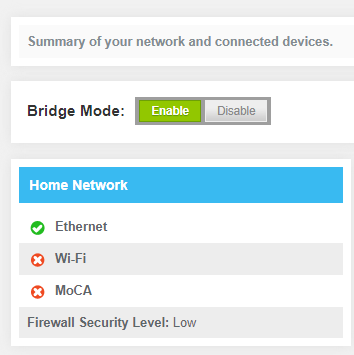

1) The modem is in Bridge mode.
2) It's in Bridge and all the WiFi broadcasts from the Xfinity router are off.
I will read the KB articles, just in case. It seems clear though, that this is not just me. Very weird indeed.
